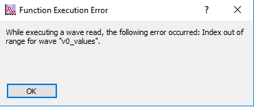

But this function doesn't work properly. Function Execution Error arises. Please find attached the error message and created wave v0_values. The last 5th row in this wave is wrong. How can I solve this problem?
Error (3.28 KB) v0_values wave (2.2 KB)

One thing to note is that the first thing in the function is to create a new wave so if you have 5 data waves originally you will now have 6 total waves. The wavelist function could be tailored to avoid including that wave.  Another strategy is to have separate data folders for input data and analysis waves.
In reply to by Physicist92
This is a good place to put in a plug for the debugger.  Using this, you might have discovered that ItemsInList was returning a different value from what you were expecting.
