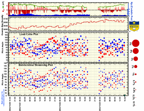

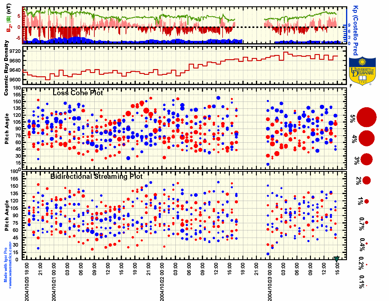

And here is a sample graph from Roger's web site. Click for full size view.
