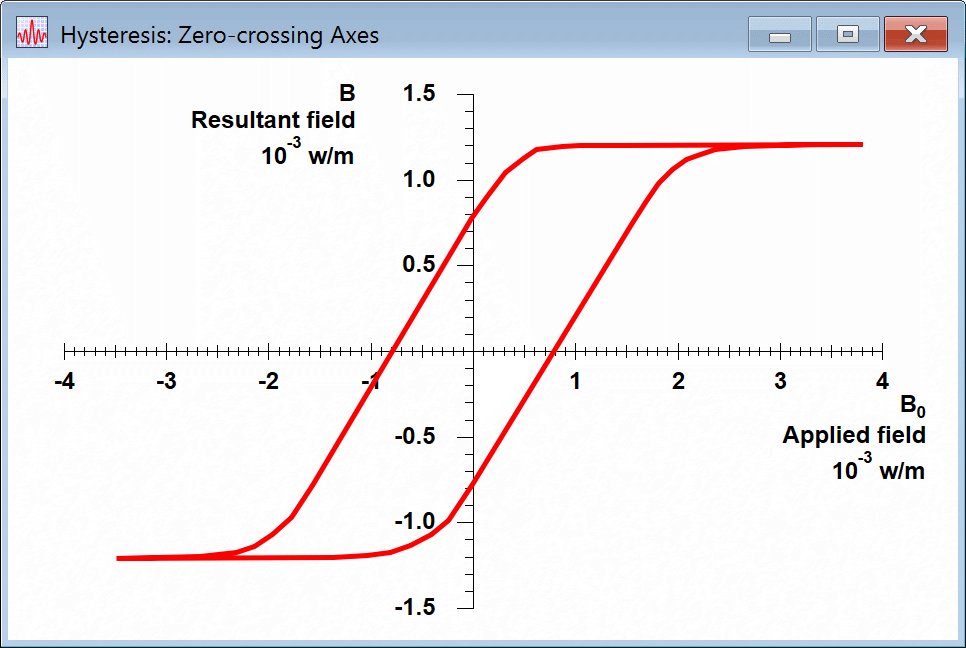

By way of example, assume we wish to change the color of the trace in this graph to blue:

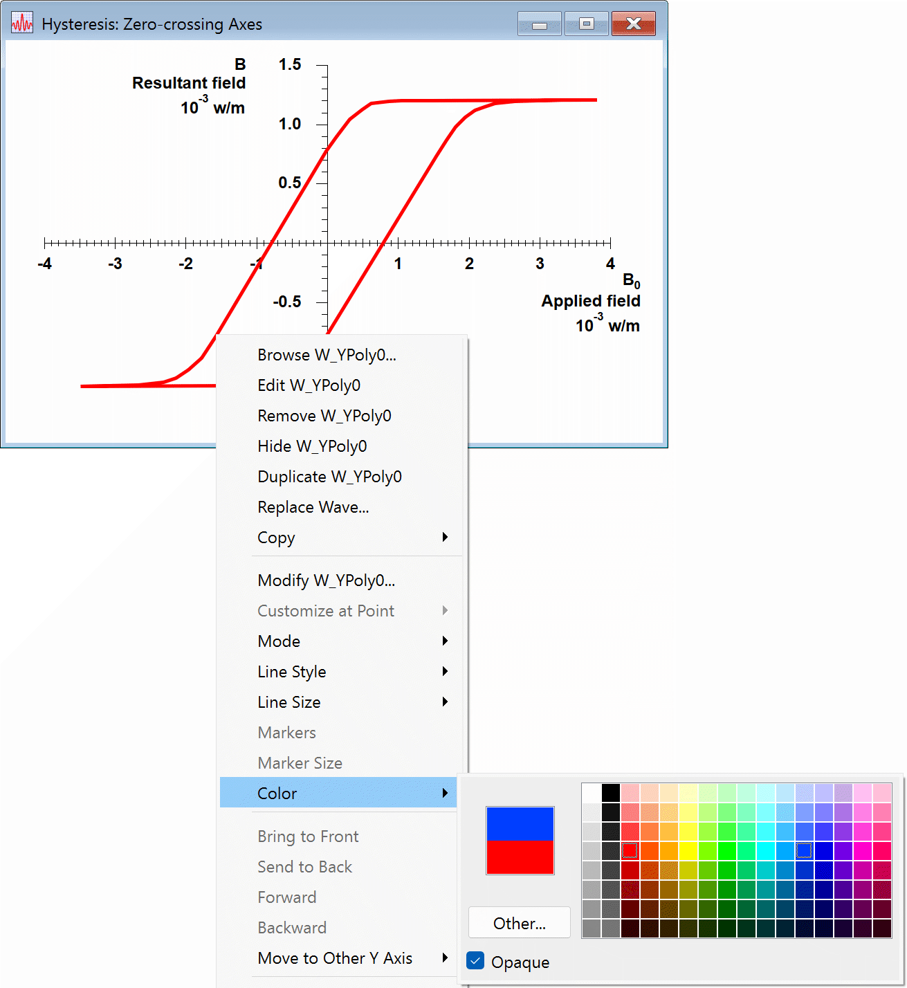

One way would be to right-click and choose from the contextual menu:

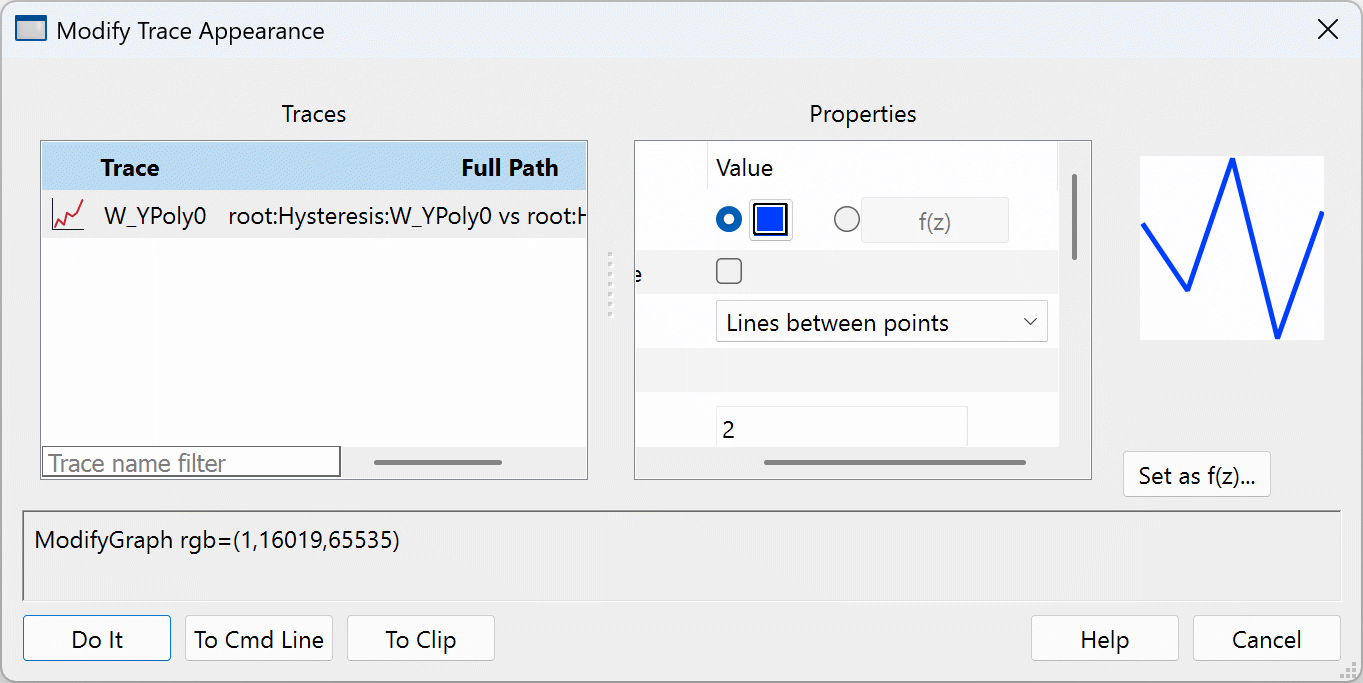

Or, you could double-click on the red trace to bring up a dialog. The following shows the dialog after the color blue has been selected:

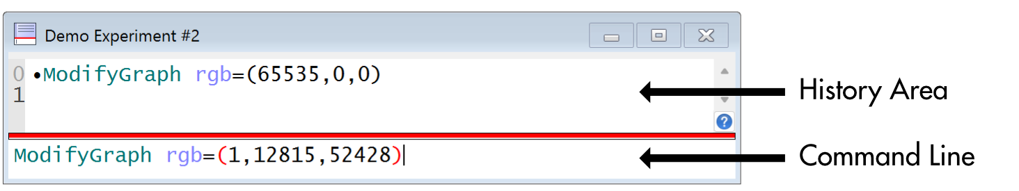

The command shown will be executed when the Do It button is clicked. For purposes of illustration, the To Cmd Line button was pressed which simply places the command on the command line without execution as shown here:
The history area shows a previous command (which set the color to red) while the command about to be executed is on the command line.
Pressing the Enter key on the keyboard tells Igor to execute the command(s) in the command line (which in this case will change the color of all traces in the top-most graph to blue).
The history area provides a record of what you have done and commands can be easily be modified and re-executed.
