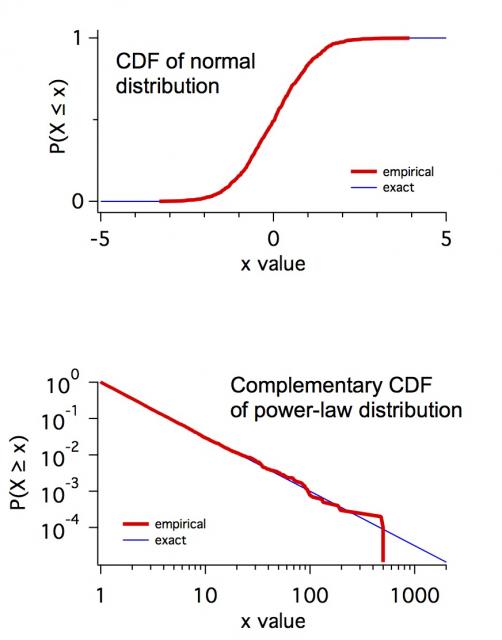

Cumulative Distribution Function (CDF)
The code below will estimate the cumulative distribution function, P(X≥x) from a wave of observations. There is an option to plot the complementary cumulative distribution function, P(X≤x), as well. Note that an alternative way to calculate this would be to create an ordinary histogram and integrate. The version presented here is without binning. The two advantages are that (1) you don't have to worry about optimal bin size and (2) you do not lose any information.
The attached example program shows typical results.
