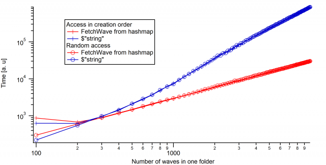

variable numWaves = 1000 for(i = 0; i < numWaves; i+=1) string wvName = "X_" + num2str(i) Make/O/D $wvName endfor UpdateIndex Make/O/I/N=(numWaves) indexWave indexWave[] = abs(enoise(numWaves-1.0)) Wave/Z wv for(i = 0; i < numWaves; i+=1) wvName = "X_" + num2istr(indexWave[i]) FetchWave/L=wvName /DEST=wv if(!WaveExists(wv)) printf "Error at %s\r", wvName endif endfor
The experiment in the zip archive was then used to create the attached benchmark.
DO NOT USE THAT IN PRODUCTION CODE AS IT MIGHT FAIL HORRIBLY!
