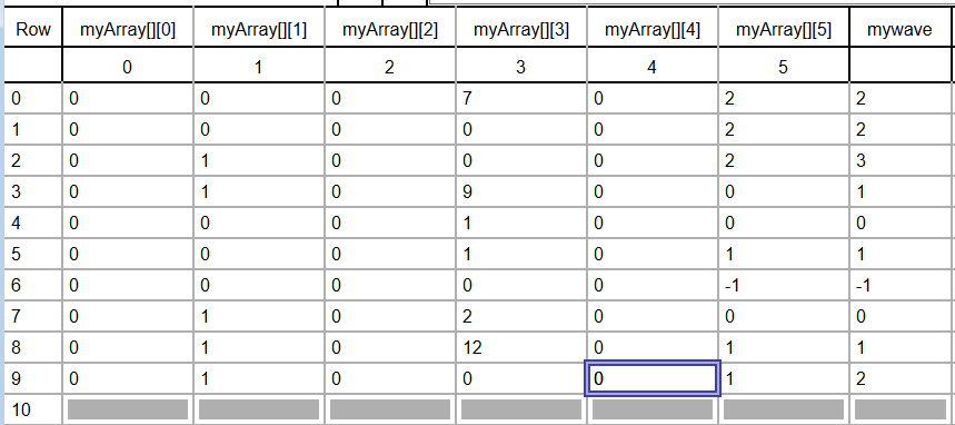

Hi Andy,
I don't want to add another dimension nor to append data on the end of the 1Dwave.
If I had, say, 'column' 1 of the multiDwave ie. multiDwave[][1] with the following values 0 0 1 1 0 0 0 1 1 1 and 'column' 5 multiDwave[][5] with these values in the 10 'rows'. 2 2 2 0 0 1 -1 0 1 1 and then add these into the 1Dwave and get 2 2 3 1 0 1 -1 1 2 2 for the 10 'rows' respectively.

This is the answer I want to get in mywave
February 14, 2024 at 08:52 am - Permalink
