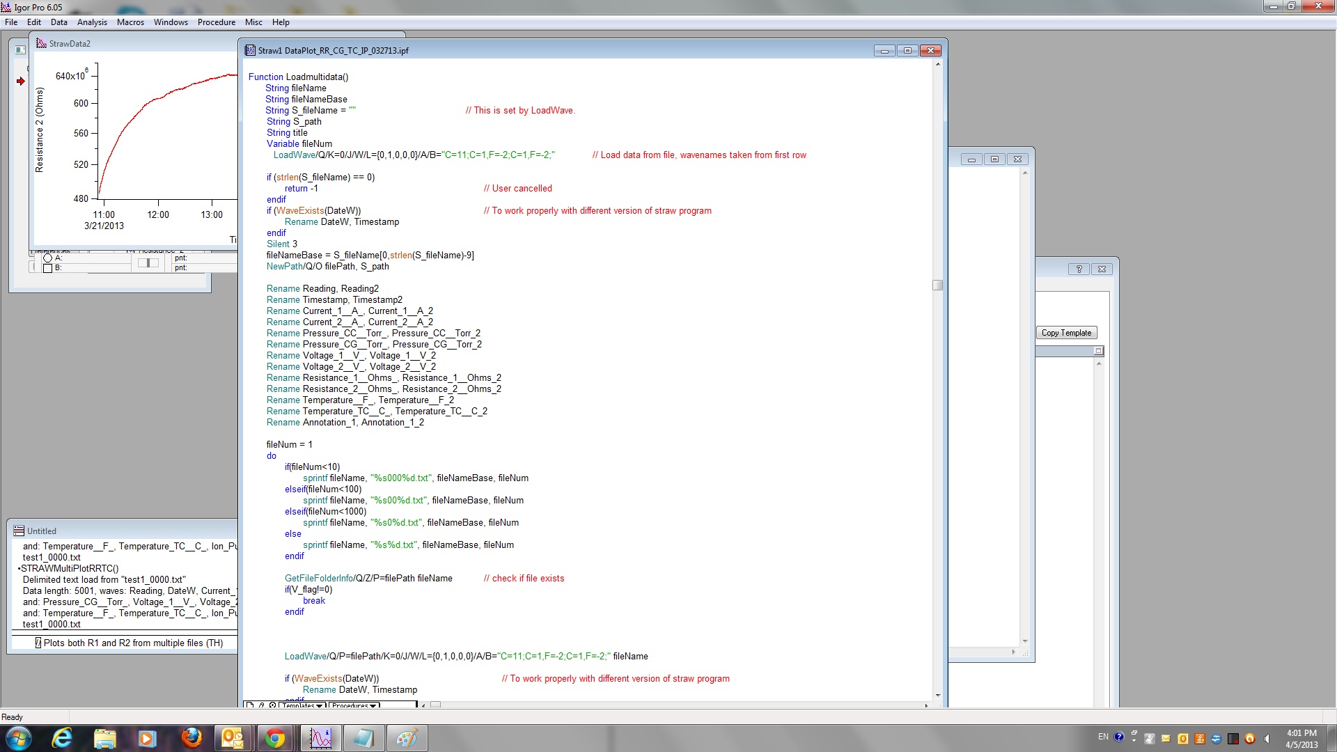

I have old igor procedure to load a group of multi olddata. now the newdata has been added an extra column named "Ionpump". I like to revised the igor procedure to load both group of multi old data and new data.

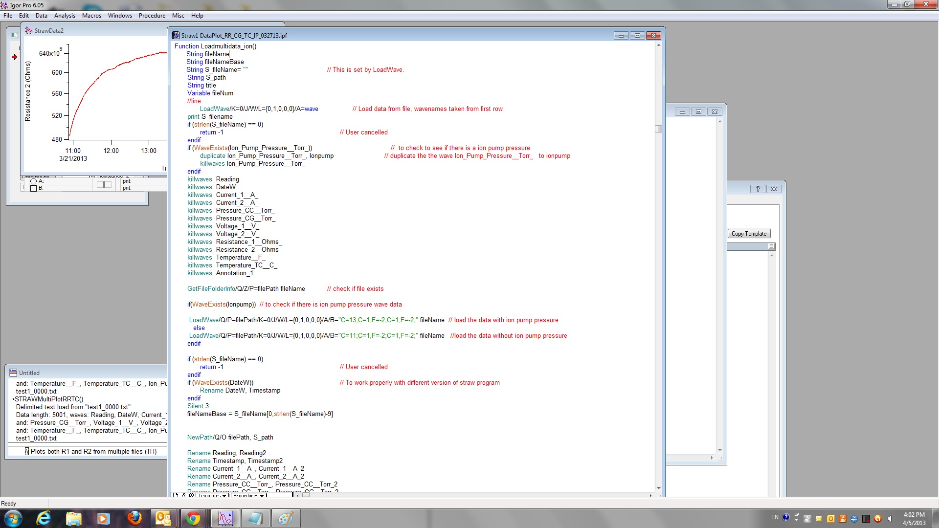

The idea I planned to do is to load a single file first and check whether there is the column named "Ionpump". If the wave"Ionpump" exists, start to load the multi newdata, if not, start to load multi old data. The new igor procedures works fine for loading both groups of old data and new data, but a "Function Execution Error" with "Attempt to use a null string varible" came out at the end.
Please see the part of igor in attached file.
old igor procedure:
Function Loadmultidata()
      String fileName
      String fileNameBase
      String S_fileName = ""                            // This is set by LoadWave.
    String S_path
    String title
    Variable fileNum
         LoadWave/Q/K=0/J/W/L={0,1,0,0,0}/A/B="C=11;C=1,F=-2;C=1,F=-2;"         // Load data from file, wavenames taken from first row
New Igor procedure:
Function Loadmultidata_ion()
     String fileName
      String fileNameBase
      String S_fileName= ""                         // This is set by LoadWave.
    String S_path
    String title
    Variable fileNum
    //line
        LoadWave/K=0/J/W/L={0,1,0,0,0}/A=wave           // Load data from file, wavenames taken from first row
    print S_filename
    if (strlen(S_fileName) == 0)
        return -1                                       // User cancelled
    if (WaveExists(Ion_Pump_Pressure__Torr_))                           //  to check to see if there is a ion pump pressure
        duplicate Ion_Pump_Pressure__Torr_, Ionpump                          // duplicate the the wave Ion_Pump_Pressure__Torr_   to ionpump
        killwaves Ion_Pump_Pressure__Torr_
    killwaves  Reading
    killwaves  DateW
    killwaves  Current_1__A_
    killwaves  Current_2__A_
    killwaves  Pressure_CC__Torr_
    killwaves  Pressure_CG__Torr_
    killwaves  Voltage_1__V_
    killwaves  Voltage_2__V_
    killwaves  Resistance_1__Ohms_
    killwaves  Resistance_2__Ohms_
    killwaves  Temperature__F_
    killwaves  Temperature_TC__C_
    killwaves  Annotation_1
    GetFileFolderInfo/Q/Z/P=filePath fileName       // check if file exists
    if(WaveExists(Ionpump))  // to check if there is ion pump pressure wave data
     LoadWave/Q/P=filePath/K=0/J/W/L={0,1,0,0,0}/A/B="C=13;C=1,F=-2;C=1,F=-2;" fileName  // load the data with ion pump pressure
     LoadWave/Q/P=filePath/K=0/J/W/L={0,1,0,0,0}/A/B="C=11;C=1,F=-2;C=1,F=-2;" fileName   //load the data without ion pump pressure

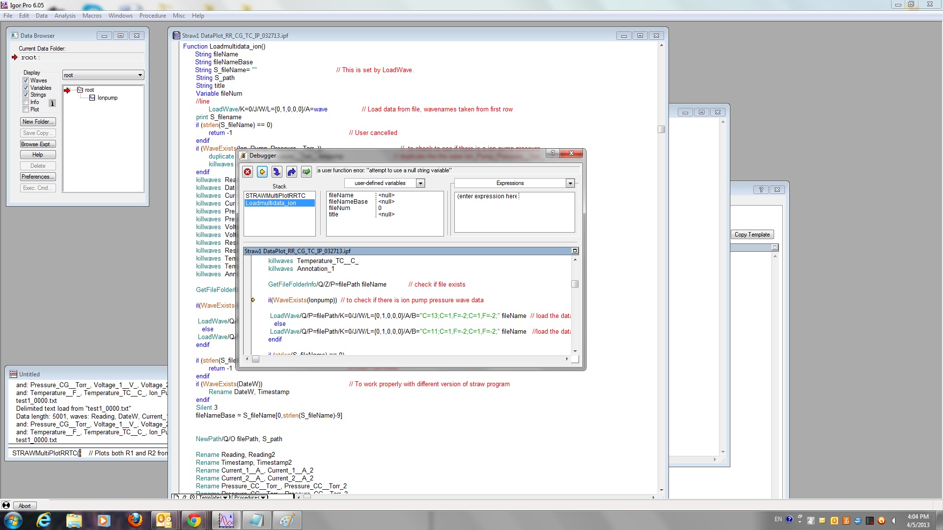

Use the debugger enable, the execution paused at line "if(waveexist(ionpump))" and said "attempt to use a null string vavariable". Since this line doesn't involve any
string variable, it confused me. It would be appreciated if anyone could give some suggestions. Thanks.

[quote]the execution paused at line "if(waveexist(ionpump))" and said "attempt to use a null string vavariable". Since this line doesn't involve any string variable, it confused me.[/quote]
The debugger often stops one line after the real problem. In this case the real problem is that the string variable fileName is uninitialized. Note that fileName is not the same as S_fileName which is automatically created and set by LoadWave.
