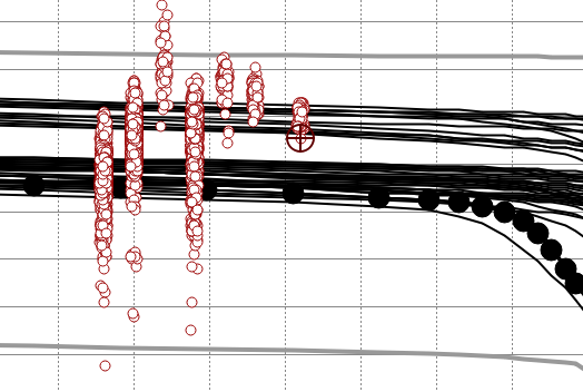

I'd like to make some beeswarm plots that overlay dense data so that the distribution is easily inferred. Each vertical cluster of points has the same x value so it is impossible to see the density of measurements
I made a small function to randomly jitter the data's x-coordinates, which helps a little but I'd like to try something like a beeswarm plot.
I know violin plots and box plots are built in to Igor... is there a way to leverage that package to do this? I haven't dissected the source code but would appreciate any insight.
screenshots seem to have broken. Files attached here.

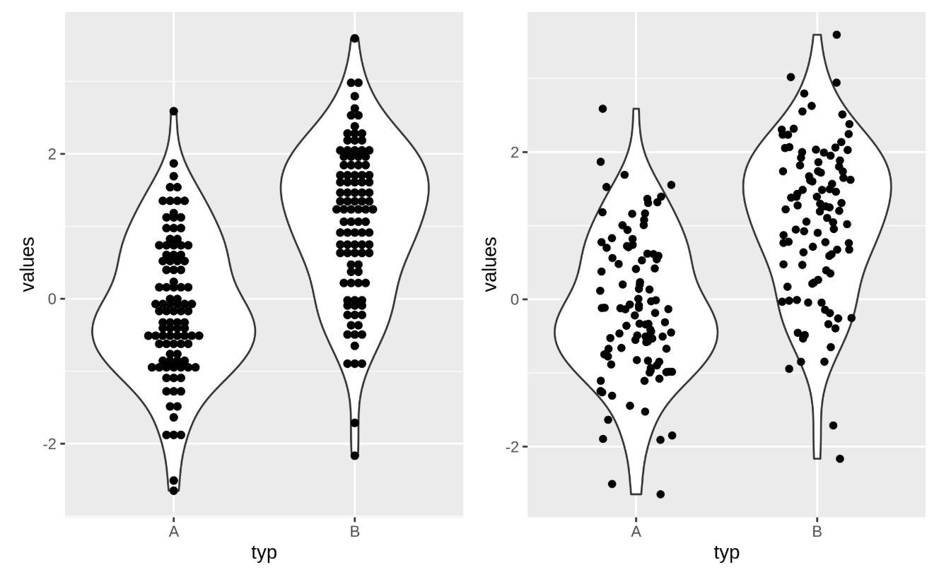

[1] https://stackoverflow.com/questions/63138870/jitter-according-to-density
