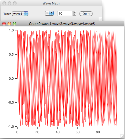

Perhaps then what you would want is to build something starting from this example experiment. It has a panel to do allow you to do simple math functions on traces in a graph. The result is returned directly to the trace selected. It makes use of shorthand notations "wave += X" ,"wave -= X", "wave *= X", or "wave /= X" to do the math operations.
WaveMathPanel.pxp (50.22 KB) WaveMathPict.png (106.71 KB)

Oahh !!!! thank you so much JJWeimer ....this is exactly what I was looking for ..Thanks to Proland also..
I will try to incorporate this in my code and will come back later to say how it works...Thank you so much to both of you.
