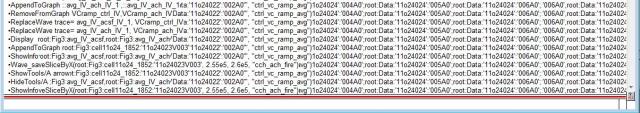

I am using Igor Pro 6.22A and Windows 7 and I am having trouble with the Command Window. When I type in new commands, the line does not clear itself correctly. If a previous output string in the command history was longer than the current line, I see the longer part of the old string "behind" the current string. I have attached a screenshot of a portion of the window that shows an example of the problem. Note that the last command was "ShowInfo". If I minimize the window or do something else that causes the whole window to "re-paint" then everything looks normal.

My theory is that this problem is a bug in your video driver. Before changing the scrolling mode, you might try some things to see if it fixes the problem:
Restart your machine (I have see that fix strange problems)
Great! That seems to have done it. Not sure it helps you, but the default scrolling setting in the nightly was even worse than in 6.22A. The ScrollingMode switch solves it, though.
In case it helps, I am using a dual-screen monitor setup on a GeForce 8300 card with NVIDIA driver version 285.62.
