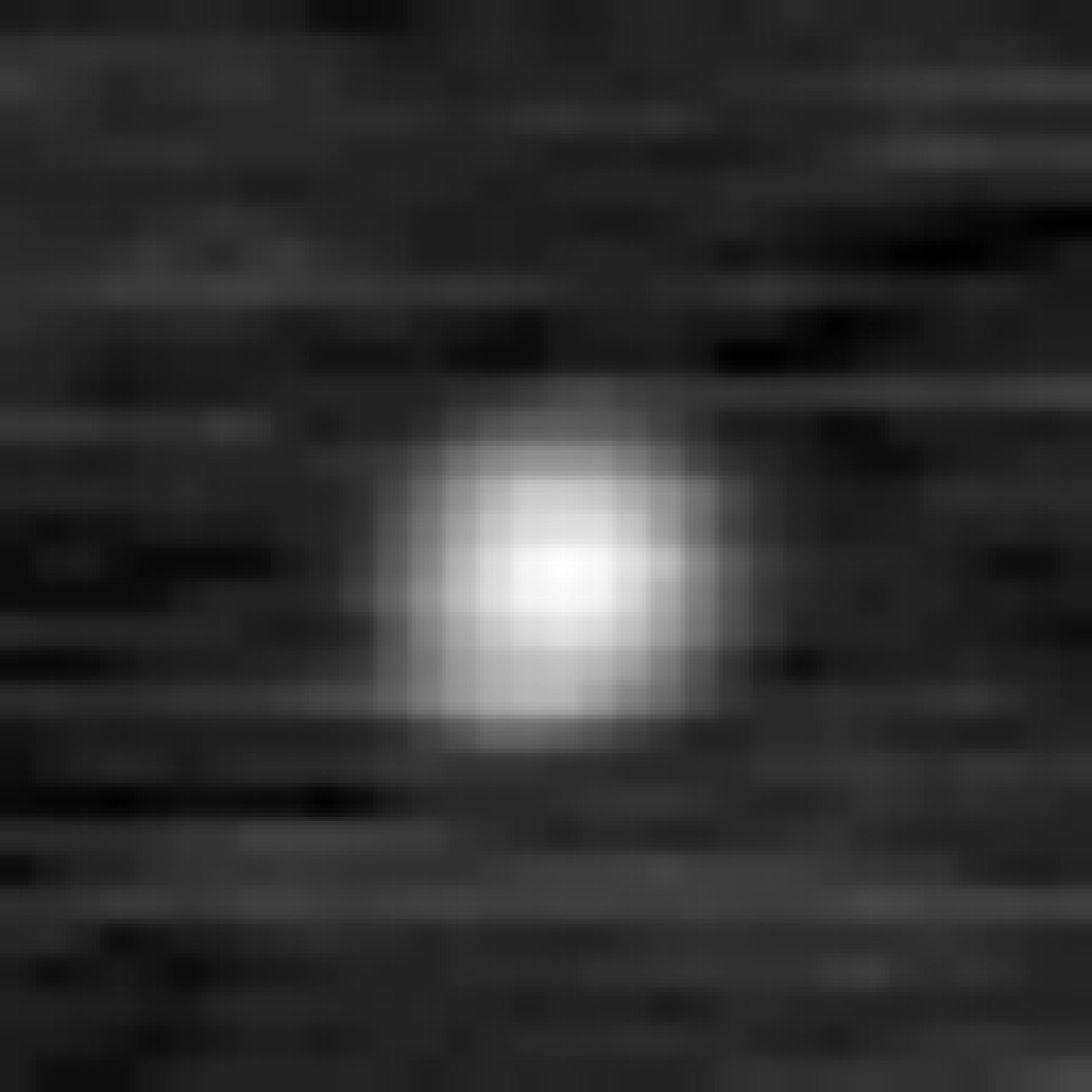

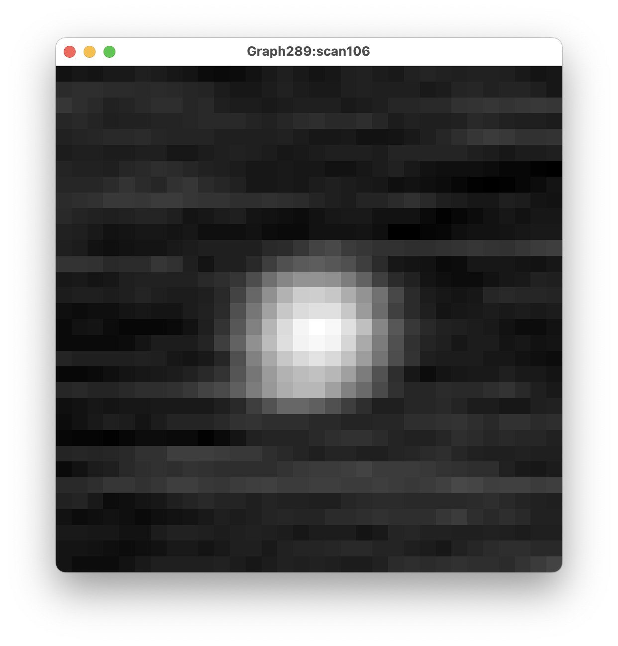

I have a graph containing an image. If I copy it to the clipboard (or choose Edit/Export Graphics), then paste it into another program (e.g., Mac Preview or PowerPoint) the resulting image is extremely blurry, as if some smoothing is done in the copy process. Is there a way to get a high-resolution paste (ideally as a pdf?) The example images show the issue for an image that is originally 32 x 32 pixels (the top image is the pasted one, the bottom image is as it appears in Igor.)
Image pasted into Preview Image as seen in Igor graph

Using Igor 9.01, I cannot reproduce your result, i.e., I get a sharp image of a small wave (e.g., 10 x 10) when pasting into Powerpoint using both png and svg export. I did not do an exhaustive test however. First, it would be great if you could tell us your Igor version and OS (looks like Mac?), and which settings you were using in Edit/Export Graphics.

I did not see the problem on a quick test on my Mac OS 10.14 system with Igor Pro 9.01 so it may depend on which version of Mac OS and/or Igor that you are using.
I find that I have the same issue when saving to a pdf using File.../Save Graphics (or SavePICT/E=-2), so it's not only a clipboard issue. Interestingly, the resulting pdf is blurry in Mac Preview, but sharp using Adobe Acrobat. It seems like programs that use the Mac's pdf rendering engine blur the image, while those (Acrobat, MS Word) that use their own engine are sharp (with the exception, unfortunately, of PowerPoint). This agrees with the help topic pointed out by Howard.
If I save as a png the image is sharp in every program. If I save using
ModifyImage name_of_image_wave interpolate= -1
as suggested above, the pixels are sharp but there is a very thin but visible white border between each one.
I guess I'll just save as png for now, given that these images were just supposed to be in a Powerpoint for a presentation.
You're right that Preview blurs images and there doesn't seem to be anything to do about it. It causes us quite a few tech support questions!
