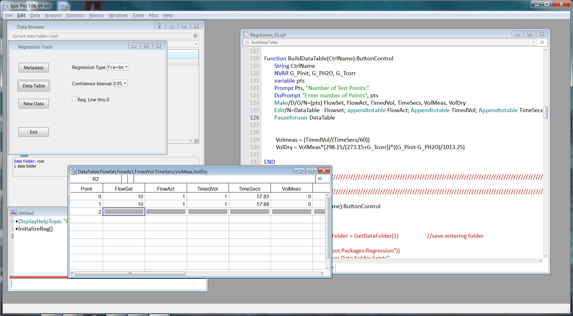

John, can you elaborate more please. I have zero experience with control panels and pause for user. Please explain the need for a control panel and what it must contain. By simply inserting a PAUSEFORUSER command there is no way to continue. I have attached a screen shot and inserted my code, but I am obviously missing something. After inputting some values into the table ans cannot continue. The table won't close and I have to use windows task manager to close down IGOR.
Function BuildDataTable(CtrlName):ButtonControl
    String CtrlName
    NVAR G_Pinit, G_PH2O, G_Tcorr
    variable pts
    Prompt Pts, "Number of Test Points:"
    DoPrompt "Enter number of Points", pts
    Make/D/O/N=(pts) FlowSet, FlowAct, TimedVol, TimeSecs, VolMeas, VolDry
    Edit/N=DataTable   Flowset; appendtotable FlowAct; Appendtotable TimedVol; Appendtotable TimeSecs; Appendtotable VolMeas; Appendtotable VolDry
    Pauseforuser DataTable
//  I want to enter values in the table at this point and when execution continues execute the next
//  two lines to complete the table.
     Volmeas = (TimedVol/(TimeSecs/60))
     VolDry = VolMeas*(298.15/(273.15+G_Tcorr))*((G_Pinit-G_PH2O)/1013.25)
END
You can read the detailed description of PauseForUser by executing this command: DisplayHelpTopic "Pause For User"
A control panel is an Igor window with user-programmed GUI. For your application, you need a pretty simple one: a button for "Done", a button for "Cancel" and possibly a TitleBox control with a message to the user.
Your example acts the way it does because PauseForUser prevents interaction with any window other than the table until the table window is killed. But there is no provision for killing the window that is accessible to the user (that is, you). Hence, the need for a control panel that has a button that will either accept the changes or cancel the changes and then kill the main PauseForUser window. Here is a very simple example that illustrates what I was describing:

Copy that code, paste into the Procedure window, then close the Procedure window. To run the example, execute Example() on Igor's command line. You will see a pair of badly-placed windows (the panel shouldn't really lie on top of the table) that allows you to edit the table or click the buttons in the panel, and nothing else. The action procedures for the panel buttons (AcceptButtonProc() and CancelButtonProc()) kill the windows. The panel is the PauseForUser main window, and when it is killed PauseForUser returns and the function stops executing. Killing the table isn't required, but you indicated that it should be temporary.
John--
Thanks for the example. While walking back from lunch it dawned on me that I could use case statements that are selected via the buttons in a panel to do the different things I want. I was thinking the PauseForUser command had some sort of built in method to pause execution and then resume without much programming and that I was missing it. This example helps a lot.Thanks for taking the time to whip it up for me.
