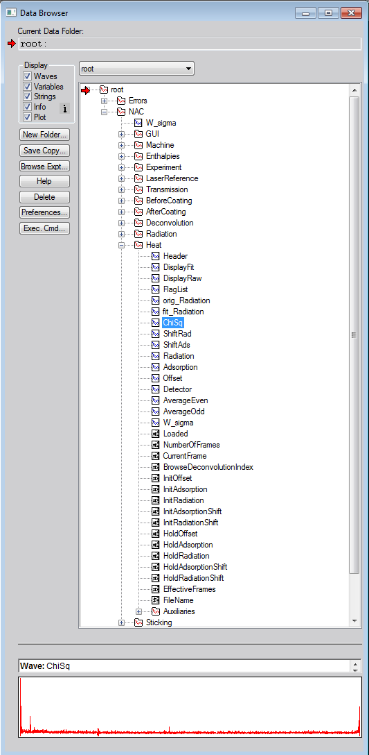

Some run times with identical data (Exp0042LT):
a) Data browser with expanded data folders: 51.5297 s; 53.977 s; 53.5698 s
b) Data browser with collapsed data folders: 18.2537 s; 18.3133 s, 18.2515 s
c) Data browser with expanded data folders minimized: 29.6672 s; 30.217 s; 29.6042 s
d) Data browser with collapsed data folders minimized: 15.9292 s; 16.0841 s; 15.8868 s
e) Data browser closed: 15.102 s; 14.3829 s; 15.086 s
The run times (mstimer) are consistent. Minimizing the tree structure ("NAC") seems to provide the largest improvement. Result c) is surprising. Although the DB is minimized it still updates and costs a lot of time.
You want to see if the fits (3000 in this case) are particularly bad in some range (Wave ChiSq -- marked blue). Yes I could graph them automatically, but I don't want to; there are enough graphs already :-) (and one needs this only in case the result looks "suspicious")

Not so surprising. The DB in IP6.x is an XOP. As such it performs its work when it gets idle time from IGOR. As long as the DB window exists (even minimized) it gets its idle messages which give it an opportunity to update its internal structures. If you want it to become dormant you need to close the DB window as I said before.
