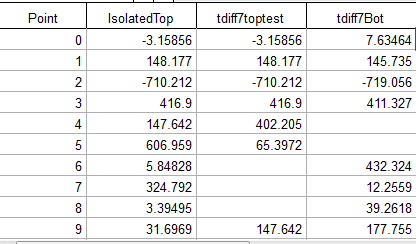

I hope I'm being clear about what I need.
I essentially want to delete the topwave points when both top and bottom waves have real numbers. So referring to the image I attached, the isolatedtop wave should have blanks, and then have numbers after the 3rd index.

Deleting a point is not the same as setting the value of the point to blank/NaN.
Which do you want?
November 7, 2018 at 10:25 am - Permalink
In reply to Deleting a point is not the… by JimProuty
Sorry for not being clear. I want to set the value to a blank/NaN.
November 7, 2018 at 10:33 am - Permalink

How about:
topwave = Numtype(BotWave)==2? Topwave : NaN
If topwave is a NaN then it stays a NaN
if Botwave is a NaN then the topwave remains the same whether it is a real value or a NaN
if Botwave is a real number then it changes topWave at that point to NaN
The result is a topwave with real values and NaNs.
If you want to subsequently remove the NaNs from topwave you can do a wavetransform zapnans.
November 7, 2018 at 11:00 am - Permalink
