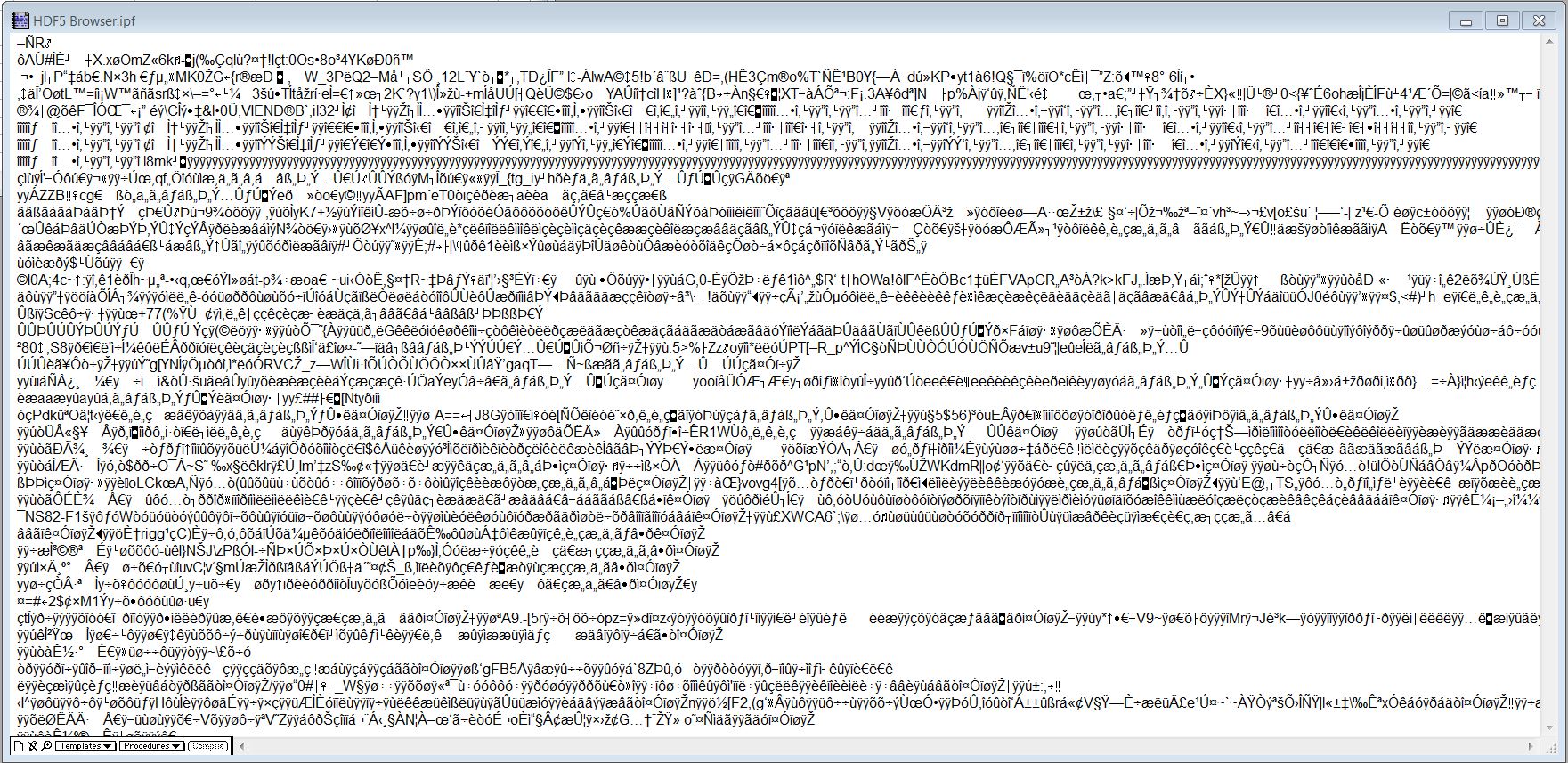

Going to Windows->Procedure Windows->HDF5 Browser.ipf only shows a bunch of unreadable characters. I've attached a screenshot of what I see. Do I need to open the file with a reader outside of IGOR?

[quote]Going to Windows->Procedure Windows->HDF5 Browser.ipf only shows a bunch of unreadable characters. I've attached a screenshot of what I see. Do I need to open the file with a reader outside of IGOR?[/quote]
"HDF5 Browser.ipf" is plain text but your copy of it is garbage.
Determine where your "HDF5 Browser.ipf" file is located by activating it and choosing Procedure->Info. The file should be located in "Igor Pro Folder\WaveMetrics Procedures\File Input Output".
If it is located there, then your installation is messed up. You should uninstall and reinstall Igor.
If, as I suspect, it is not there, then it would appear that you dragged a file from somewhere and renamed it or it was corrupted somehow. Delete it and reactivate HDF5 XOP. For instructions on installing HDF5 support, execute this:

Okay, so I did a search and I have 2 "HDF5 Browser.ipf" files. One is located under "\WaveMetrics\Igor Pro Folder" and is the file that is messed up. The other file is located where you suggested ("Igor Pro Folder\WaveMetrics Procedures\File Input Output")and has readable text in it. It says that it is version 1.04. Should I just delete the bad file? Do I need to do anything to active the other file?

[quote]Should I just delete the bad file?[/quote]
Yes.
[quote]Do I need to do anything to active the other file?[/quote]
Follow the instructions in the help topic I reference above. This is necessary only if you want to load data from HDF5 files.
