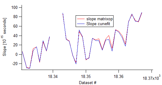

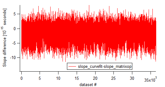

The resulting slopes for a given subset of data and the difference between both are displayed in the attached images.
