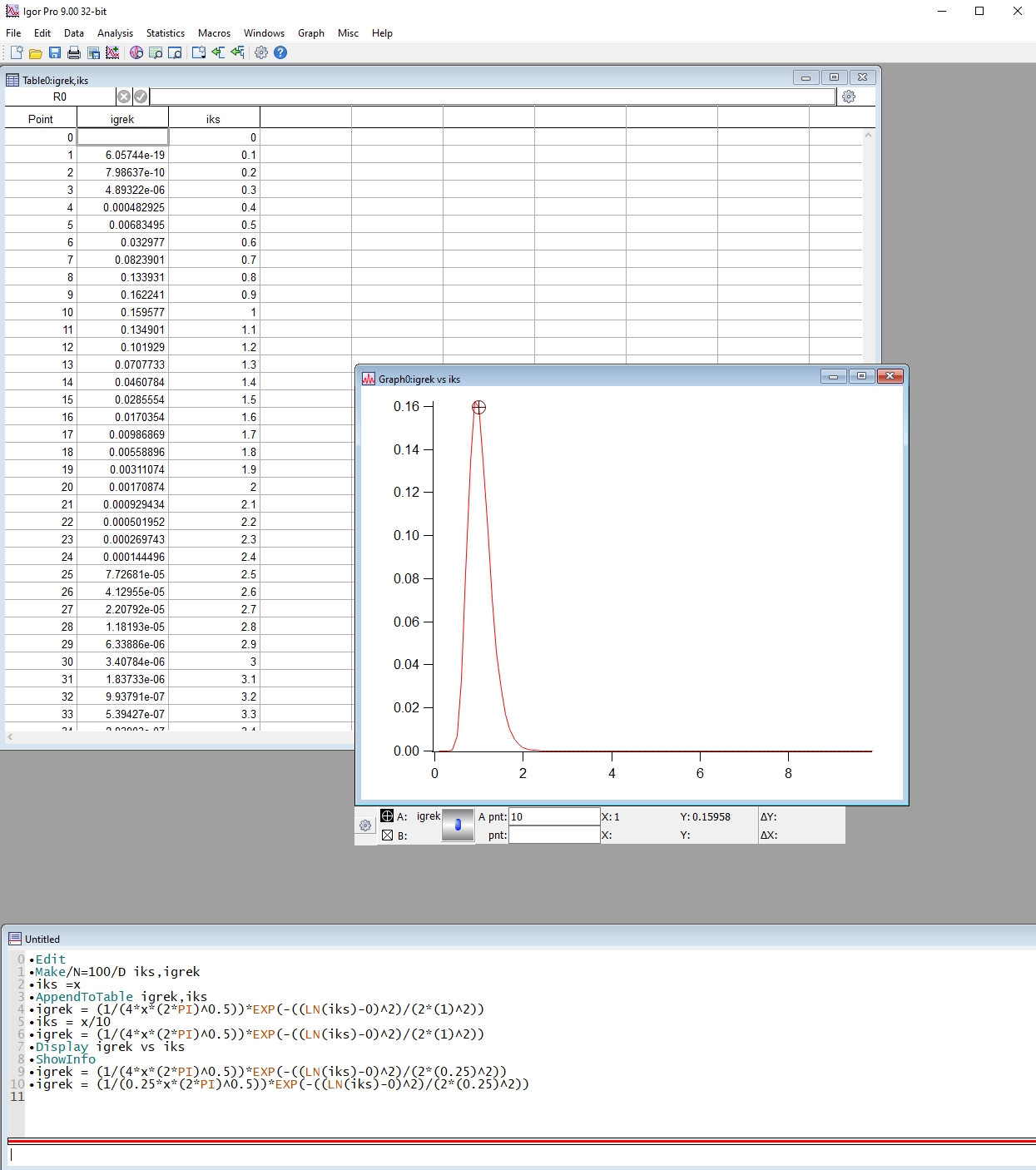

make/N=101/D igrek
SetScale/P x 0,0.1,"", igrek
display igrek
igrek = (1/(4*x*(2*Pi)^0.5))*exp(-((ln(x) - 0)^2)/(2*(0.25)^2))
not sure if line 10 does what you expect: you have x and iks on the right-hand-side and the are not the same. I assume you want only one of them.

Yes you are right. I used both x and "iks" wave in the equation.
Regardless the equation in correct:
Y = (1/(0.25*x*(2*Pi)^0.5))*exp(-((ln(x) - 0)^2)/(2*(0.25)^2))
or
Y = (1/(0.25*iks*(2*PI)^0.5))*EXP(-((LN(iks)-0)^2)/(2*(0.25)^2))
And it produces lognormal distribution.
But that is beside the point. I can fit using igor's lognormal fitting, but I can't extract commonly used parameters. I read the help file, but the parameters I get, don't make any sense.

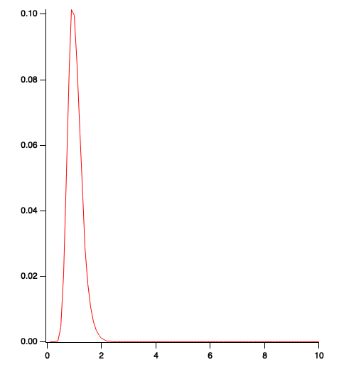

If I plot the results from Igors curve fit, it does not look like it can be fitted with, say 0.5 and 1, as initial guesses in myLogNormal (although I don't know what the x-scaling of fit_wave1 is).
Can there be some scaling issues with your data?

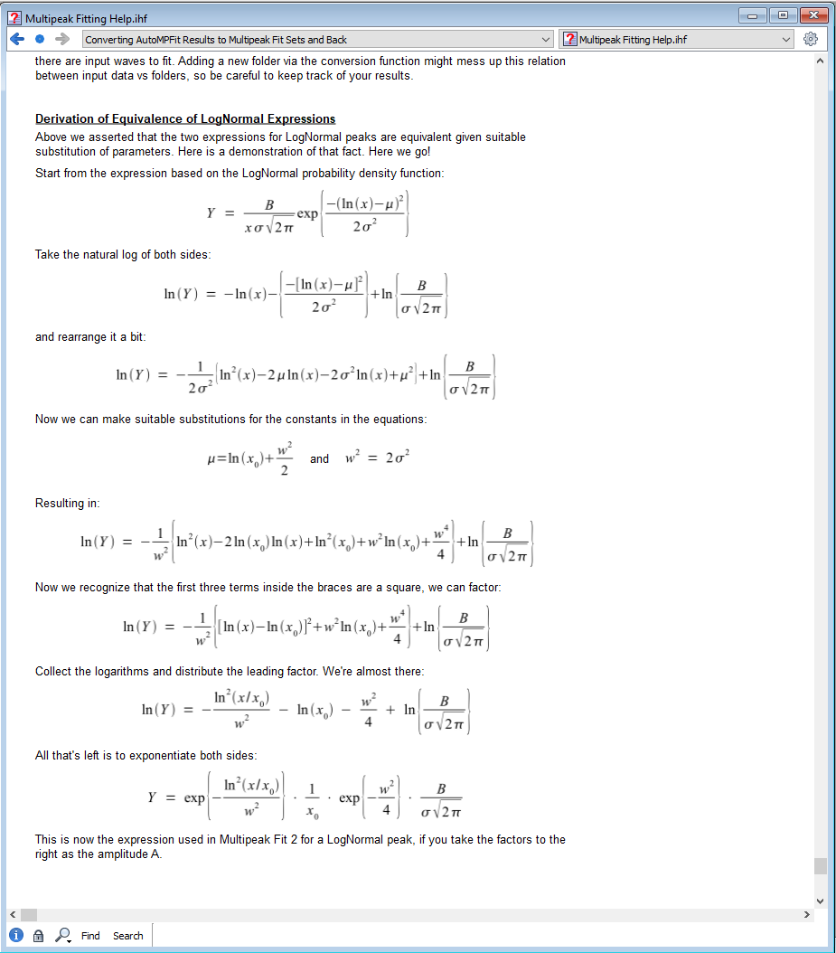

The answer is in the help file screenshot that you posted.

this uses the lognormal PDF equation and produces the same curve as the lognormal fit function.
you can do the same thing in reverse if you want to use sigma and mu as fit coefficients.
