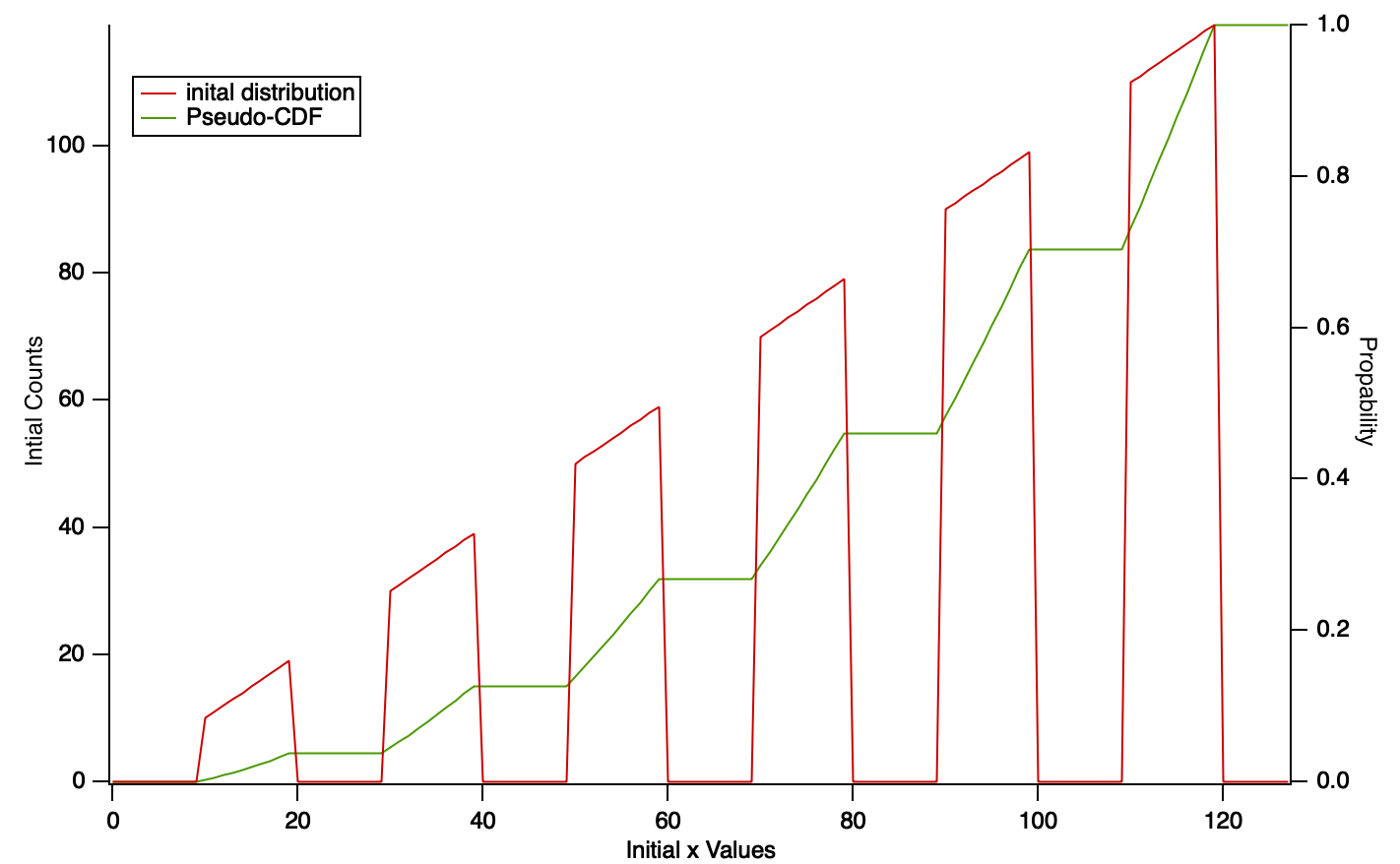

What I was thinking is to integrate the initial prCounts function to create a pseudo-cumulative distribution function.  I would normalize to 1 so the range of probability goes 0-1.  I would then get a random value (0-1) from a uniform distribution(enoise(value)) and then do a search the pseudo-CDF to get a corresponding input value.
I mocked up an example and hopefully it aligns to your request.
Made a probability function, red, and note it is not normalized.  These could be counts from a sensor or whatever.  I then integrate that curve to create a cumulative distribution function and I have normalized it to 1.  Now to get a random value from it you seed a uniformly seeded number fro enoise and input into a findlevel command to return a value based on your initial x value range.  For example if I do a findlevel CDF, 0.3 it returns 70.7887.
Hopefully this makes sense and does it do what you need?
probability CDF.png (116.5 KB)
