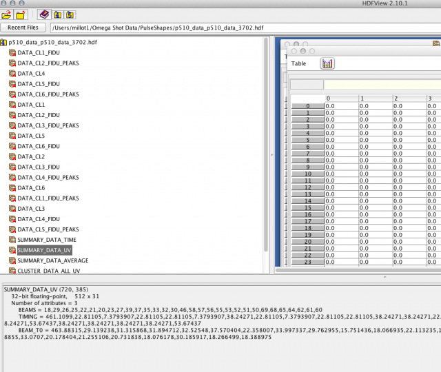

I need to read hdf4 files having an unknown number of sds and extract the data and attributes of the SDS which contains a given keyphrase in the attributes: see screenshot from hdfviewer: I want to read the data from summary_Data_time and Summary_Data_UV as well as the list of Beam numbers in the attributes of Data_Summary_UV.
I am really confused with the hdfinfo and hdfreadsds...
Using a matlab script with i being an integer for the refnumber i do
info.SDS(i).Name to access to the SDS name and scan over the various ref numbers to find the one for which the name matches 'SUMMARY_DATA_UV'
then to get the list of beams I do
info.SDS(ii).Attributes(1).Value
I see how to use hdfinfo sdsinfo to get the number of SDSs but then I don't see how to perform such a query with hdfreadsds
