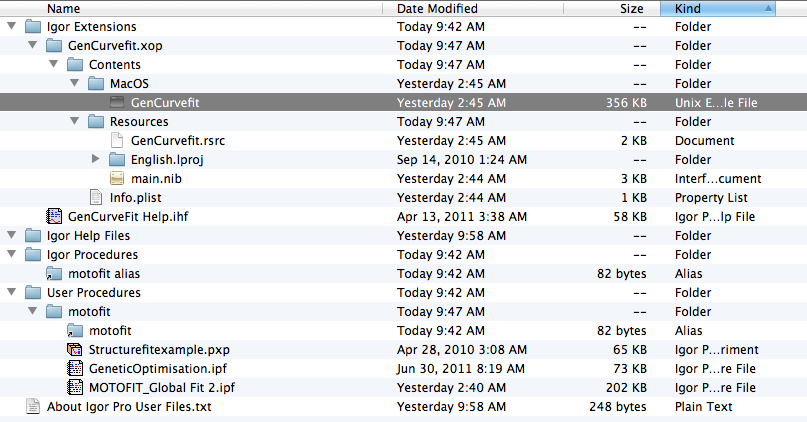

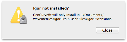

Igor not installed? GenCurvefit will only install in ~/Documents/Wavemetrics/Igor Pro 6 User Files/Igor Extensions
The reason for this is the line in distribution.dist that checks for a file in the following location:
'/Users/andrew/Documents/WaveMetrics/Igor Pro 6 User Files/About Igor Pro 6 User Files.txt'
modifying that line to match my system allowed me to install.

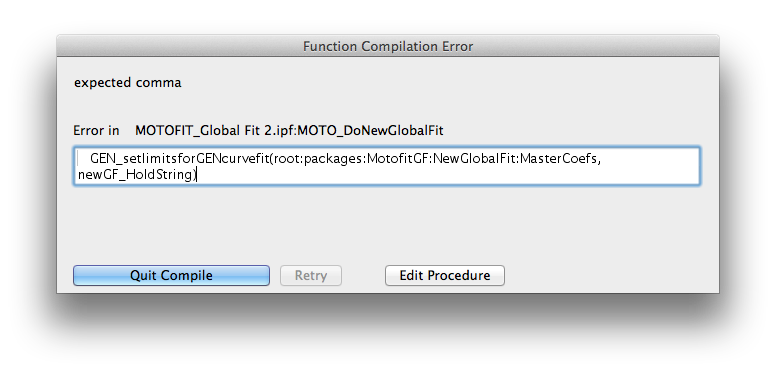

Upon launching Igor, I get several errors from compiling MOTOFIT_Global Fit 2.ipf
expected comma Error in MOTOFIT_Global Fit 2.ipf:MOTO_DoNewGlobalFit GEN_setlimitsforGENcurvefit(root:packages:MotofitGF:NewGlobalFit:MasterCoefs, newGF_HoldString)
I have attached a third screenshot of my Igor Pro User Files directory. Perhaps something is out of place?
Thanks again!
October 1, 2011 at 12:49 am - Permalink
