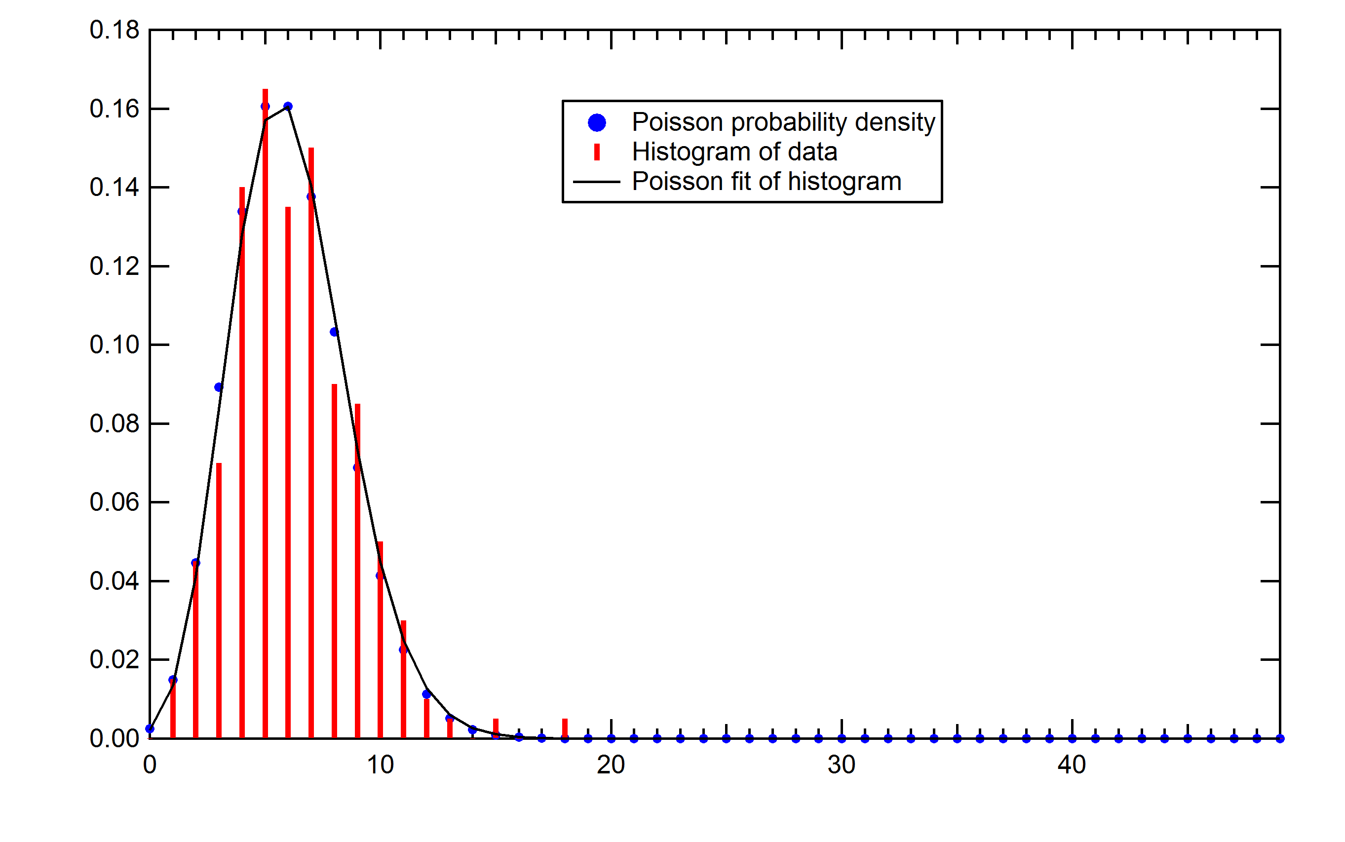

What I have done is to generate approximate artificial Poisson data using Knuth's method (cited in your reference) for a specified mean value. Then I created a histogram of that data. Finally that was followed by a curve fit to the Poisson distribution:

You have to be careful that the fitting takes place only on the integer values of the data and of the Histogram. Do not use the /CUM flag on the Histogram. I attach a figure showing an analytic Poisson PDF with mean value 6, the histogram of 200 data variates simulated using that mean, and the curve fit of the Histogram data to the above function. The fit shown gave mu = 6.1284 . I used a limited number of "measurement" samples to demonstrate that the fit is not exactly along the analytic result, and that the histogram can deviate a lot from the ideal case.

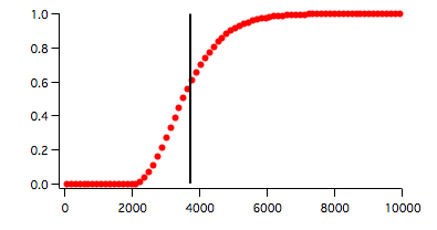

To clarify the problem: I take a confocal image of a fluorophore solution. Thus, every pixel should have the same intensity, more precisely they should be Poisson-distributed around the same expectation value EXP(I). To determine EXP(I), I want to treat the 1024x1024 pixels as 1mio independent measurements of EXP(I). I look at the histogram of the image and want to find EXP(I) by fitting a Poisson PDF of CDF. Attached are images of the histogram and the cumulative histogram.
However, the best estimator should actually be the mean value (I indicated it with the black line) - but it does not look like that to me --> I might have a wrong understanding of the maths.

I wonder if you need some scaling factor, or an X offset. It seem like a Poisson curve with peak at such large numbers is more nearly Gaussian.
Your picture looks very much like a Gamma distribution, which could be fit using a user-define fitting function that wraps our StatsGammaPDF or StatsGammaCDF functions. Since they are continuous distributions, fitting will be more straightforward.
