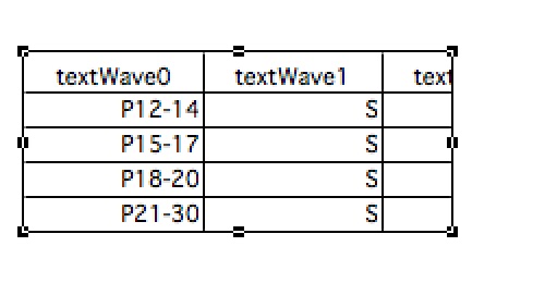

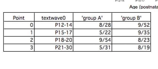

resizing is not working as I expected. If I drag the edge of the table in the layout, the width/height of the column/row won't change, but the amount of the column/row will decrease/increase. As shown in the attached pic, column textwave2 is halfway displayed after I drag the right edge of the table.
another Q is how to hide one specific cell like in the pic, I want to hide the cell displaying "textwave0"
many thanks

You can set "textWave0" to blank by setting the column title for the column to " " (there is a space between the quotes) using the ModifyTable operation or the Modify Columns dialog. For example:

thank you very much for the tips, hrodstein,
That fixed my problem. In addition to my previous Q, how to modify the height of the row? and can I type two lines of text/number in one cell?
thx!!
May 3, 2015 at 06:13 am - Permalink
You must change the font size.
No.
