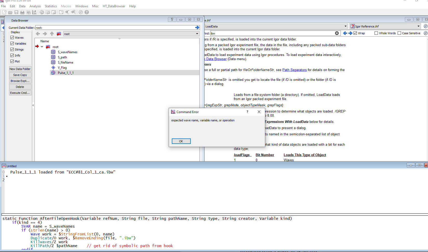

Do I run this as a function or as a macro?
I have dragged and dropped the file, then pasted this script in the cmd line but I got an error (kindly see the picture)
August 17, 2022 at 06:05 am - Permalink
Paste the function into the built in procedure window (type <Control>M to open OR open from windows>procedure windows menu) & recompile the procedure. Then drag & drop your file onto Igor.
