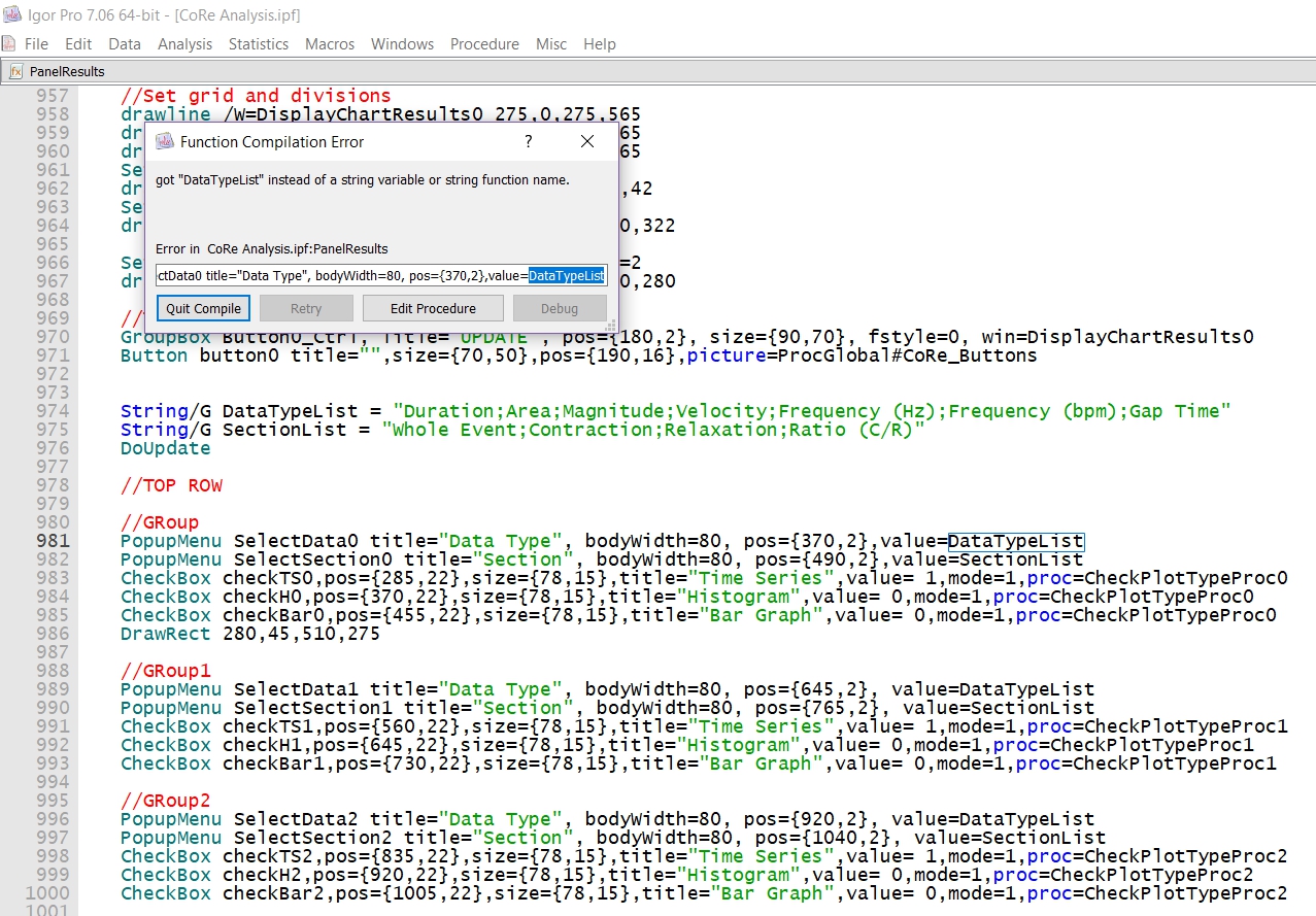

Essentially, it seems Igor does not recognizes my string list I use for a PopupMenu.
String DataTypeList = "Duration;Area;Magnitude;Velocity;Frequency (Hz);Frequency (bpm);Gap Time"
String SectionList = "Whole Event;Contraction;Relaxation;Ratio (C/R)"
DoUpdate
//TOP ROW
//GRoup0
PopupMenu SelectData0 title="Data Type", bodyWidth=80, pos={370,2},value=DataTypeList
PopupMenu SelectSection0 title="Section", bodyWidth=80, pos={490,2},value=SectionList
I attach an image to illustrate and you can see the error message, and the DataTypeList string list

Note that, in your screen dump, you do not have:
String DataTypeList
but rather
String/G DataTypeList
Don't create global variables except for things that have to persist from one invocation of a function to the next.
