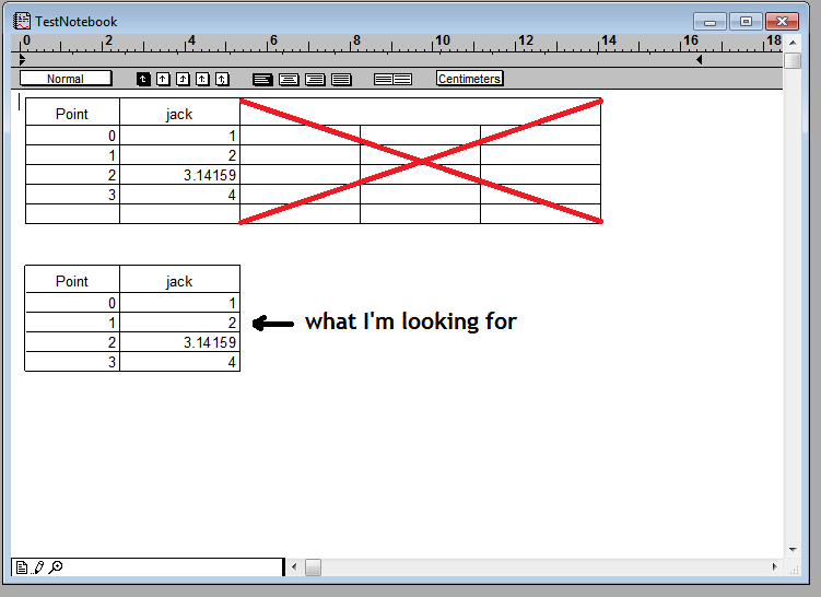

I'm writing a procedure to generate reports and I'm wondering if it's possible (Is there a simple way) to insert programmatically a table in a notebook like in the attached picture.
By the way, I've done that with a copy-paste from a layout.
Thanks

But, is it possible to insert only columns with data like the first column ("jack") and not the rest of the empty table ?

You would have to resize the table window, either manually or programmatically using the MoveWindow operation, to show what you want to show.
Alternatively you can display the values of the wave as plain text:

what I'm looking for is explained in the attached image...

It works with "MoveWindow" but I have to adapt the size for each table because my tables do not necessarily have the same number of lines.
But it's a good start, I keep looking ...
