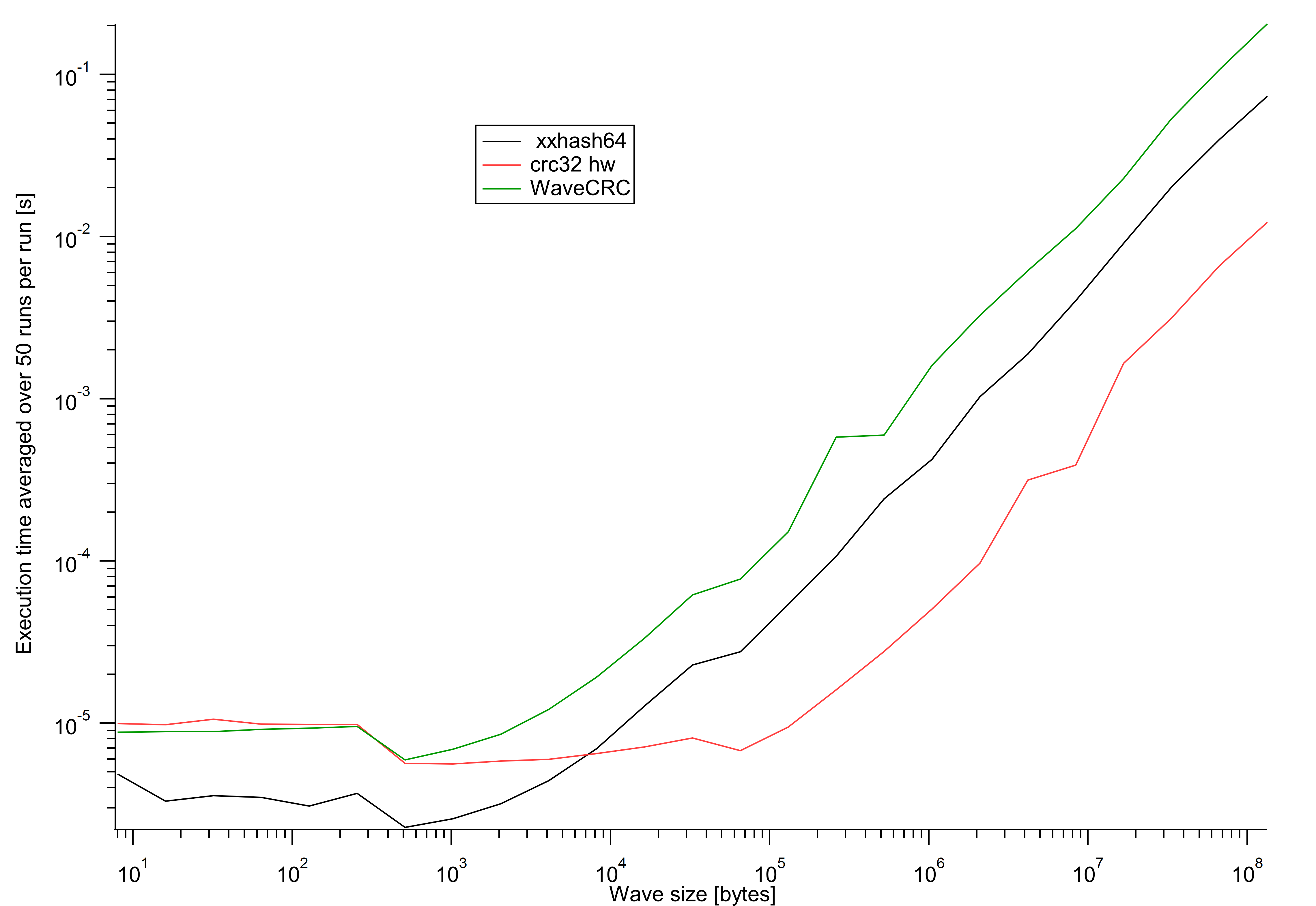

Thanks to hint of a coworker I've found that the SSE4.2 instruction set supports CRC32 [1, 2], altough not with the same polynominal as WaveCRC.
The attached graph compares the speed of WaveCRC, xxhash64 and crc32_hw for various wave sizes.
And as expected no algorithm can beat silicon.
I've used https://bitbucket.org/robertvazan/crc32c-hw/src and https://github.com/Cyan4973/xxHash and IP8 beta from today.
