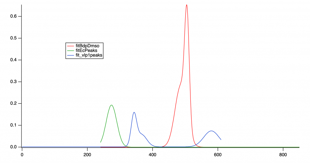

I've included my data file below (apologies for it being so messy!)–mostly take a look at Graph2. I'm trying to find linear combinations of fit_ecpeaks and fit_bdpdmso to fit fit_vlp1peaks, fit_vlp2peaks, and fit_vlp3peaks. Any help is greatly appreciated!
The first path I looked to your request was a simple linear combination using 2D polynomial fit but I could not proceed because as you mentioned the waves are different length.
Fit_vlp1Peaks is 611points
fitBdpDmso is 595 points
fitEcPeaks is 311 points
and a quick graph does reveal a linear combination seems likely.

You can do this with curve fitting.
The waves on the plot are buried within a package datafolder. First go to the data browser and set the data folder to that of your fit and reference waves. Better still, make a copy of the waves in your working data folder, rather than trying to work in a folder that's reserved for a package.
Then open the curve fitting dialog and create a new fit function.
the independent variable is x, and you need two coefficients a and b.
in the body of the function type this:
wave ec = fit_ecpeaks, bd = fit_bdpdmso
f(x) = a * ec(x) + b * bd(x)
then return to the curve fitting dialog, set initial guesses for a and b, and you're ready to fit.
March 21, 2021 at 03:57 am - Permalink
In reply to You can do this with curve… by tony
ahxieAh it worked like a gem–thank you so much!
