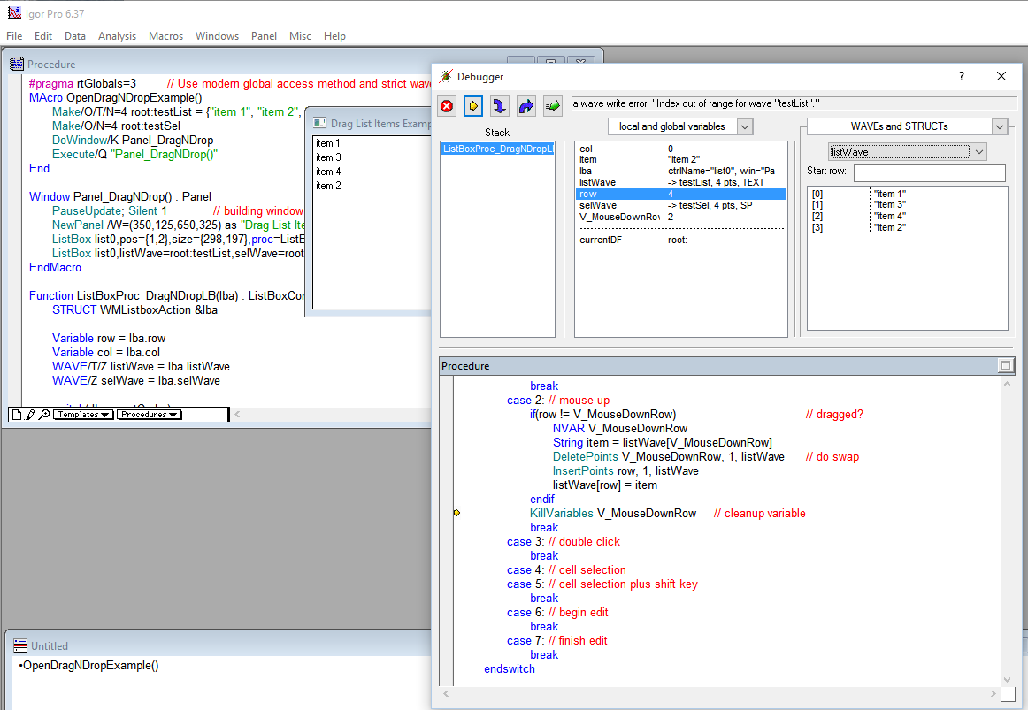

The value of row passed to the action procedure can be more than the last index of the list wave.
See the Debugger screenshot I've attached.
The first problem is that a double click actually sends a series of events to your procedure: 1, 4, 2, 3, 4, 2 -- in that order. The case 3 case doesn't capture the entire sequence.
The second problem is that the first execution of case 2 kills your V_MouseDownRow global variable. So the second time case 2 is called, this variable is null. The check for row != null is true, so the following code executes and as Jim pointed out, row is greater than the last index in your wave. The default Igor behavior is to substitute the last value in a wave if the last index is exceeded.
Hence the error message and the reason row is replaced with the last value in the wave.
