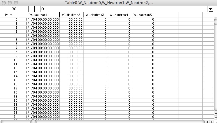

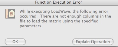

One thing is that the delimiter is actually a tab rather than a space. Is that a problem?
I've checked the trailing spaces: it is zero.
hrodstein: With your version, I get the error message shown in the -0 image.
741: Your version goes through the motion, but it doesn't load the data in the file (-1 image).
For now, I'm going to take a break. I'm using emacs and sed to convert the files to formats I can read in with Igor, and I'll return to this problem later. Thank you two for your efforts -- I'll report back if I make any progress.
April 29, 2011 at 06:06 am - Permalink
Possibly. The example you posted in your first post loaded fine with my code, but it had spaces. Howard's code might be failing for the same reason.
This should deal with tabs:

Notice that all I've done is change " " to "\t" in the calls to StringFromList and ItemsInList.
If this doesn't work either then you might want to include an actual data file.
April 29, 2011 at 07:07 am - Permalink
And we have a winner... :-)
I can't explain why the tabs got changed to spaces when I pasted the extract into my original post.
So cool, thanks a lot!
Have a nice weekend!

LoadWave/Q/J/M/D/A=tempLoadRowDataMatrix/P=$pathName/K=0/L={0,linesToSkip,linesToLoad,columnsToSkip,columnsToLoad} fileName
if (V_flag == 0)
return -1 // Probably user cancelled
ExtractRowDataInto1DWaves(tempLoadRowDataMatrix0, baseName)
