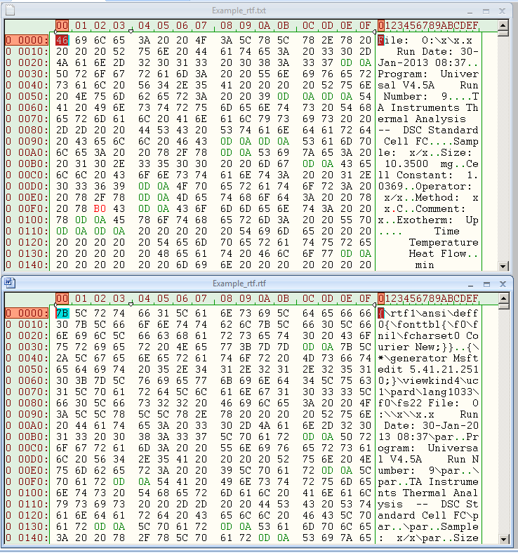

The RTF formated file includes codes that direct the formatting; the file contains more text than the values that you want to load. I've attached a screen image from a hex editor to show this. The table on the top is from the text file while that on the bottom is from the same file encoded with rich text. As you can see, the RTF format still appears to be all ASCII characters, but you will have to devise a filtering scheme to remove them.
RTF_TXT Hex.PNG (79.22 KB)
