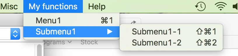

As a test I created this code:
menu "My functions"
"Menu1/1", Function1()
Submenu "Submenu1"
"Submenu1-1 /S1", Sub1_1()
"Submenu1-2 /S2", Sub1_2()
function function1()
function Sub1_1()
function Sub1_2()
And got the result you requested, I think. See Image.
Menu Test.png (75.48 KB)
