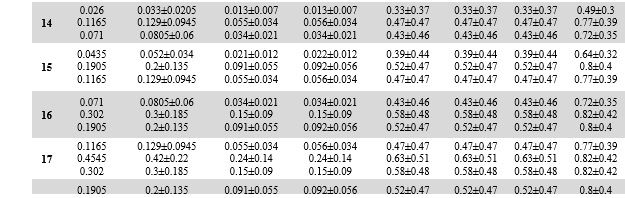

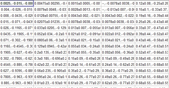

I am merging 3 tables together. I need the cells of the merged table to come out in a certain format. So, let's assume that first cell of tables 1, 2 and 3 has values a, b and c respectively. My IGOR program merges the tables to give me "a,b,c" as the first cell of the merged table. However, now I want each value to be reported in a new line within the cell. So instead of a,b,c  , I am looking for:
a
b
c
To do this, I tried adding "\r" ahead of b and c in my program but it hasn't helped. Attached is an image of the current output table, and also attached is an image of how I want the data to look. Current table output has the line change symbol ahead of b and c within each cell, but when I copy this table over to excel, the line change is not executed. Ultimately, I want to move this table to a word file. Kindly advise how to make this happen.

Current output Required output

Mergedtable[i][j]=table1[i][j]+","+table2[i][j]+","+table3[i][j]    (when each original table is text 2D wave)
This gives me an output per cell as x,y,z.
However, instead of horizontal ouput like x,y,z,  I need output with line breaks as shown in the second attached figure.
The first column of the second figure (14,15,16..) was manually inserted into the table later.
