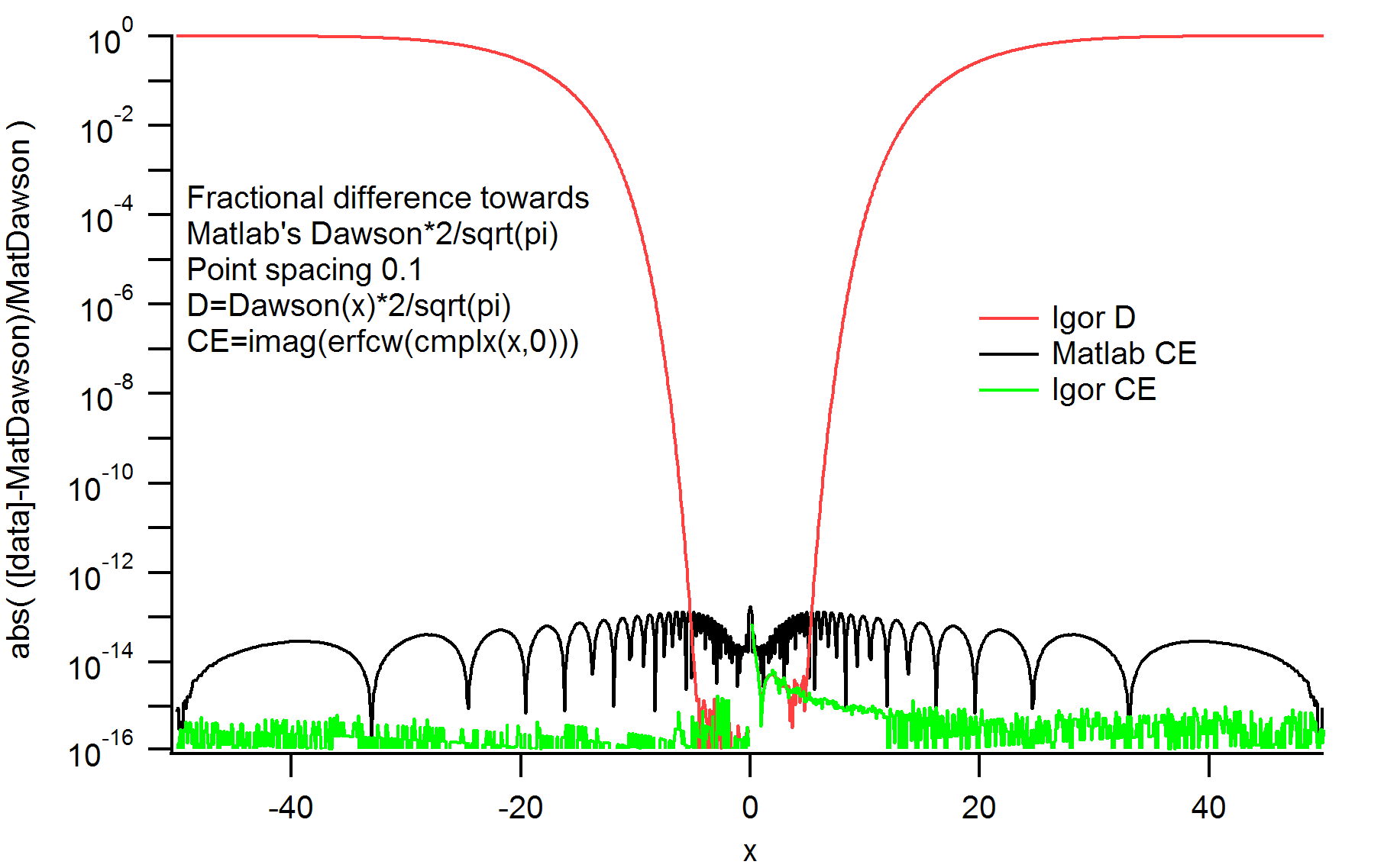

I just had a chance to compare with matlab. In Matlab, I used the built-in Dawson function and implemented the complex error function (aka Faddeeva function) according to J. A. C Weideman, 'Computation of the Complex Error Function', SIAM Journal on Numerical Analysis, Vol. 31, No 5 (Oct. 1994), pp. 1497-1518, using 30 terms.
The Matlab dawson agrees very well with the Igor erfcw, and the Weideman complex error function in Matlab is still doing fairly well, however the Igor Dawson stands apart... (see attached figure). More specifically, the igor Dawson function converges faster (I assume too fast...) towards zero for |x|>5.
I use Igor 6.2.2.2 on windows XP; the erfcw function seems to be part of Igor and is also described in the online and pdf help ... ?
