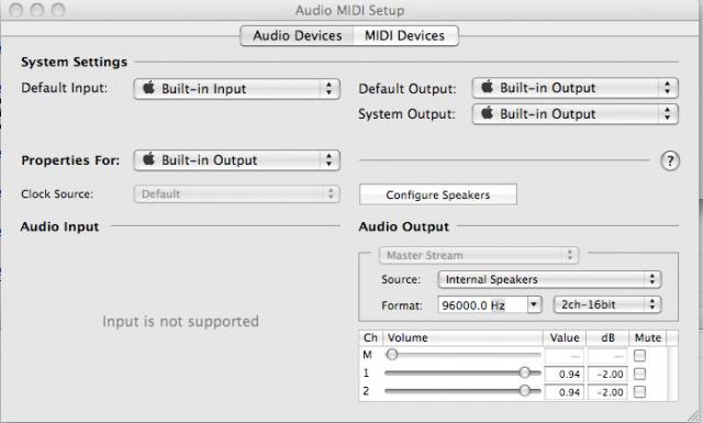

i am using IgorPro V6.04 on a MacBook Pro.
i can get sounds to play correctly at 44.1 and 48 KHz but not at 96 KHz.
this all makes sense given that the w_soundinrates wave created by SoundinStatus command reports back 44.1 and 48. however the MIDI settings of my macbook suggest that the soundcard can output 96 KHz.
my question is: why doesn't the w_soundinrates wave values reflect all the sampling frequencies of the soundcard?
thanks.
[/quote]
Probably because we are not using the latest API for sound. I'll investigate what it would take to modernize this aspect of Igor but likely it is a huge effort for very little gain.

6.11 now uses Core audio and can support floating point data, high sampling rates and multiple channels.
