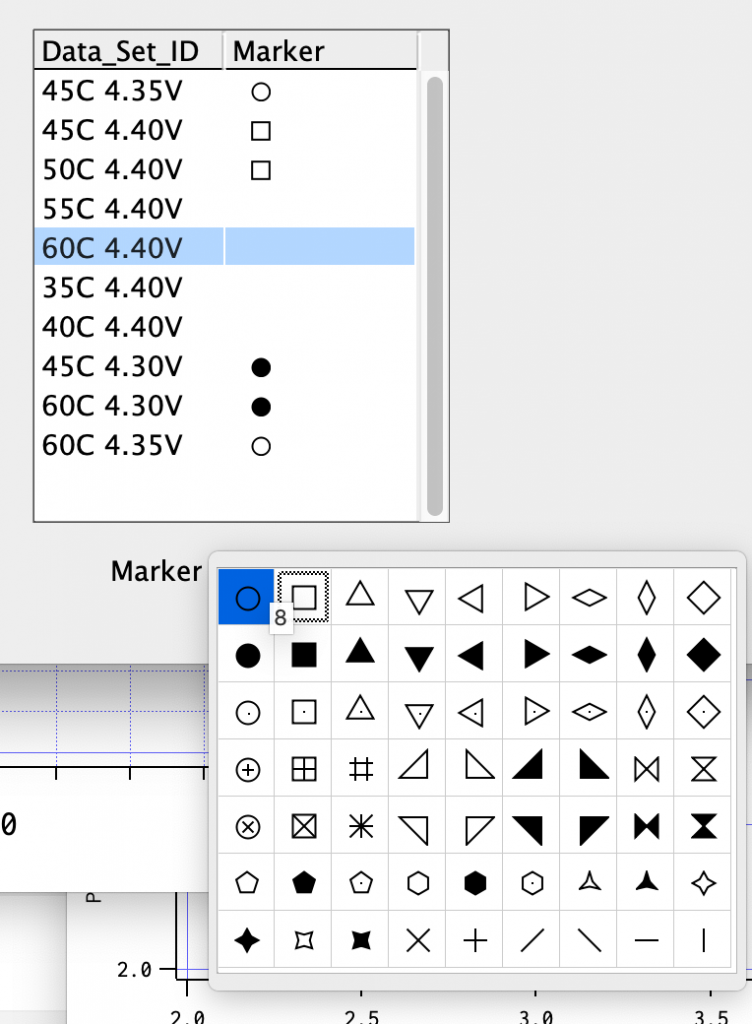

I create a listbox with the unique items in a wave and then highlight the row and can select the marker that will go with it. So far so good. Now the confusing part, if I select a row and set a marker to it and then navigate to another row and want to select the same marker, I click on the popup and go to the same marker and upon releasing mouse button nothing happens. It appears as the code does not execute if I pick the same item. I need to select a different entry from the pop up and then go back to select my original choice. I am using code event 2 in the pop up. Does the code not run if the same selection is made and if so is there something I can do to force the execution?

Some more troubleshooting.
I have two Mac computers one running Mojave and the other with Catalina and both have IP8.05B01 and IP9 Beta (Build 36830)
Here is the minimal code:
Results on Both Catalina and Mojave.
In IP8 if I make a selection on a marker the first time, the popup menu reflects that selection and the event code and marker id gets printed to history. If I then go back to control and select the same item, the dialog box does NOT dismiss. I need to make another selection which prints to history or click outside of box to dismiss.
In IP9 If repeat the process, the dialog box does dismiss, but the event code and corresponding marker id are NOT printed to history.
If I make a simple popup menu with yes/no as is default, all works as intended. Perhaps there is a bug (unintended feature) in the marker dialog box code.
