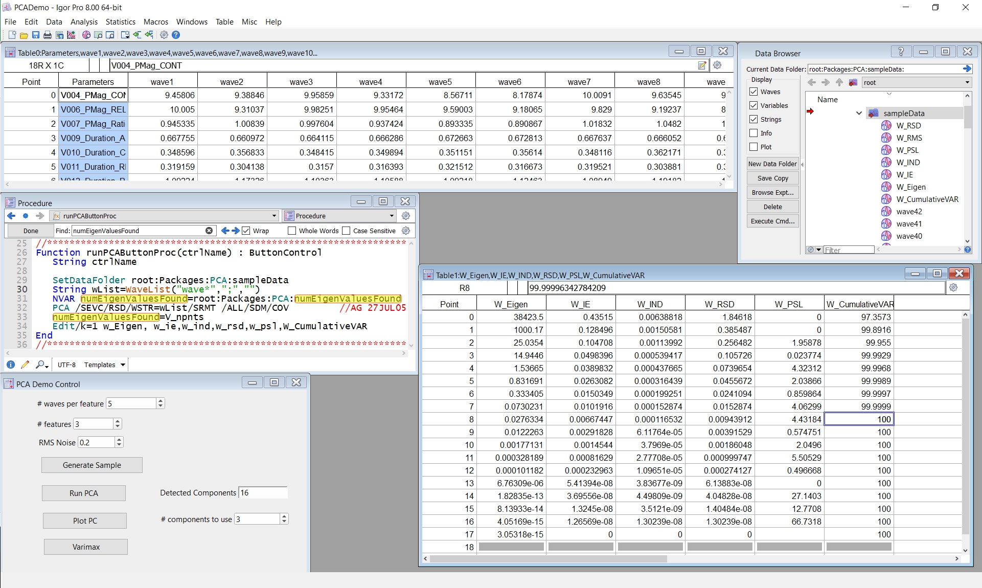

Thanks for the note. Yes, I did have a look at that example, and did attempt to run my data through it also.
Please have a look at the image attached.
What I did so far was the following:
To me, it seems I might have a lot of redundancy in my data. Is this a fair conclusion? However, I am still not sure how to connect the observation of more or less redundant parameters with the exact identification of which parameters they are. Could you give me some insight?
Many thanks!!
R.

If I only look at the eigenvalues, it seems that you have only two significant factors that together account for 99.8% of the variance.
I think it is important to note that even if you determine that there are only two important factors, these may not necessarily map to your input data. Since I am not familiar with the details of your application let me try and use an example from physics: suppose you have a bunch of waves containing xyz distribution in space and you compute the PCA and find that 99.85 of the variation is explained by two factors. That would imply that your distribution is pretty much planar. To determine the orientation of this plane in 3D space you need to look at the first two eigenvectors of the solution.
If you carry this analogy to your application, you might want to look at the eigenvectors and your inputs. In complicated cases it may be helpful to compute the projections (dot product) of your input vectors on the first two eigenvectors so you get a sense of what's meaningful and what is noise.

Many thanks for the input. Indeed, the events I included in this analysis are from one single "run" of measurements (i.e. they refer to a single subject being observed). Essentially, I am looking at the same subject at different instances, so the fact that I have 2 significant factors accounting for almost 99.85% of data variance, is likely to suggest that whenever subject is stimulated, a reaction tends to be fairly homogeneous with respect to most of the parameters analyzed. This is something I anticipated by looking at normalized distributions for each of the parameters. The situation will be different as I choose to feed PCA with averages of different runs of the experiment, where I include different subjects. So, to me, these preliminary results seem to be going the right way.
