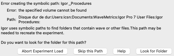

Just to confirm the pain in handling >1000 files that all ask to confirm that I no longer need to access ***:Wavemetrics:Igor Pro 7 User Files... This path was pointing at code that created the files, which now resides in *** Igor Pro 9 User files***.
I created a fake (empty) /Users/uid-something/Documents/WaveMetrics/Igor Pro 7 User Files/Igor Procedures, but still it won't work because the (absolute) path saved in the file was created with another sessions. And there are as many session names (ie absolute path definitions) as people in the lab.

Igor users relative paths if the target file (procedure, notebook, wave) is on the same volume as the experiment file. If it is on a different volume, it has to use full paths. The screenshot you attached shows the error as "The specified volume cannot be found" so I think the target folder was on a different volume from the experiment file.
By this you are referring to the screenshot which shows the Missing Folder dialog. This comes from a NewPath command written to the recreation procedures in the experiment file. If the target of the symbolic path contains no referenced external files, Igor writes a NewPath/Z command to the recreation procedures with the /Z meaning "skip if the target folder cannot be found". If you get the Missing Folder dialog, it means that a symbolic path needed to reference external files is missing, so if the Missing Folder dialog were skipped, you would get a prompt for each external file referenced using the symbolic path.
What happens when you click Skip This Path? Do you get additional dialogs asking to locate other files?
The screen shot shows that the missing folder is "Igor Procedures". Procedure files in "Igor Procedures" are automatically loaded when Igor launches and left open until Igor quits (or you manually close the procedure file). Such "global" procedure files are not explicitly referenced by experiment recreation procedures unless you explicitly open them which you should have not need to do.
All that is to say that I don't understand why you have a symbolic path pointing to "Igor Procedures" at all.
Also I don't understand why simply skipping the Missing Folder dialog would help because Igor would still need to find the referenced files.
This makes me think that perhaps you have users manually loading procedure files from an "Igor Procedures" folder that is not the "Igor Procedures" folder of the current user.
