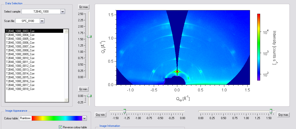

sprintf ModifyGraphCMD, "ModifyGraph/W=%s width={perUnit,%g,bottom}, height={perUnit,%g,left}",pathImageWindow,ScaleVal,ScaleVal
where "scaleVal" changes to keep the image the same size in the image window (embedded in a panel). Not the best solution, but it works! See the image.
