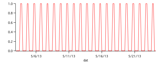

Since date/time info in Igor is stored as seconds since 1/1/1904, you can do arithmetic with waves. For instance:
make junk=x// by default, as 128-point waveSetScale/Px3450384000,14400,"dat", junk // covers a stretch of time
junk = mod(x, 86400)>43200Display junk
The above fills the wave "junk" with a square wave with transitions at midnight and noon (one day = 86400 seconds). I have attached a picture of the graph.
