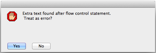

You also ignored Igor's helpful offer to treat extra text after a flow control statement as an error. Your first example then became

The above code can be typed in and it will compile and run, but I don't think it makes sense. Does It? Maybe this should be treated as an error.
The warning includes a question allowing you to make it an error, as shown by the attached screen shot. That was triggered by this code:
function test()
    if(1)
    else if (2)
    endif
end
...and the phantom-like Igor 7 treats it as an error without asking first.
John Weeks
WaveMetrics, Inc.
support@wavemetrics.com

Yep, I saw that. I meant the following might be considered an error
Function choices(angleChoice)
    Variable angleChoice
    if(angleChoice == 1)
        print "ONE"
    else
        print "TWO"
    else
        print "THREE"
    endif
End
Multiple else blocks seem acceptable to the compiler, but they don't mean anything to my sense of logic... particularly the way they are executed (see OP).
