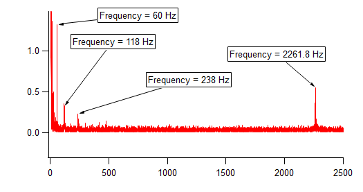

A good way to set the goal is to examine your signal for what you consider "noise". Examining the FFT magnitude (after properly setting the signal's "Wave Scaling") shows peaks in a few places (see FFT Magnitude Peaks.png, attached).

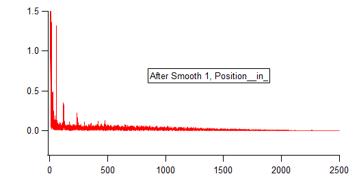

The peak near 2200 Hz is so close to the Nyquist frequency that 1 pass of the binomial smoothing eliminated it. See "FFTAfterSmooth.png".
The other noise is also attenuated, gradually less attenuation the lower the frequency.
