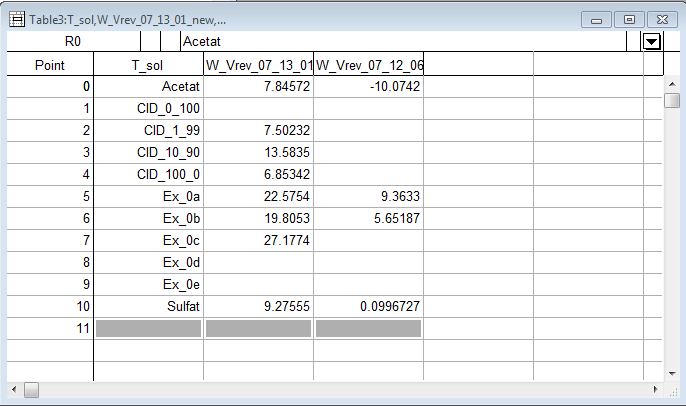

Edit: Yes, it worked, see screenshot :)
Key parts are:
and
(ignore the 0 in the first and the 1 in the second snippet, that's just due to input wave format).
Big thank you! :D
