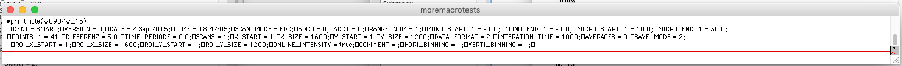

SCooil
Update,
I know that stringmatch(wavenote,"*TIME*") does return a value of 1 so the KeyStr "TIME" should work. Maybe it has something to do with the spaces in the string "TIME = 18:42:05;" not "TIME=18:42:05;" ?????
SCooil
Update,
OK I figured out the problem, by placing the string on one line the code now works. The problem is that its the program that makes the file that separates all of these values on to seperate lines with the [] symbol. I cant change that, so i have to figure out a way to remove it all when i load in my files.
any suggestions would be appreciated
SCooil
update
My code works! until i save it. then it deletes this square character when i save it and the function no longer works. it wont let me type the square(it just adds a carriage return) so i will use [].

From your screen dump, it looks like your keyword/value list has a linefeed after each semicolon. I get the same printout with this:
•String/G test = "IDENT = SMART;\nVERSION = 0;\nDATE = 4 Sep 2015;\n"

Hi hrodstein,
This would indeed work (As does my code) but unfortunately not in regards to this stupid [] character because the "replacestring" funcition would be looking for /n in the wavenote, which isn't there. Only this [] character.
Thanks for the help though
