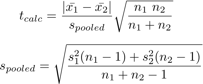

My reference from Quantitative Chemical Analysis, 7th Ed D. C. Harris gives the equations below for comparing two population sets of data with sizes n_1 and n_2. The equations apply under the assumption that population standard deviations are the same in both sets. The degrees of freedom for the t-test table will be n_1 + n_2 - 2. The F-test is used to determine if the population standard deviations are different or not.
I was wondering if n_1 and n_2 are the number of bins rather than the number of parameters. However, that itself makes no sense. My quick calculation gives s_pooled = 0.82 and t_calc = 37.97 for your data set using n_1 = n_2 = 1000.
Basically, your two results are significantly different at the 95% confidence level.
