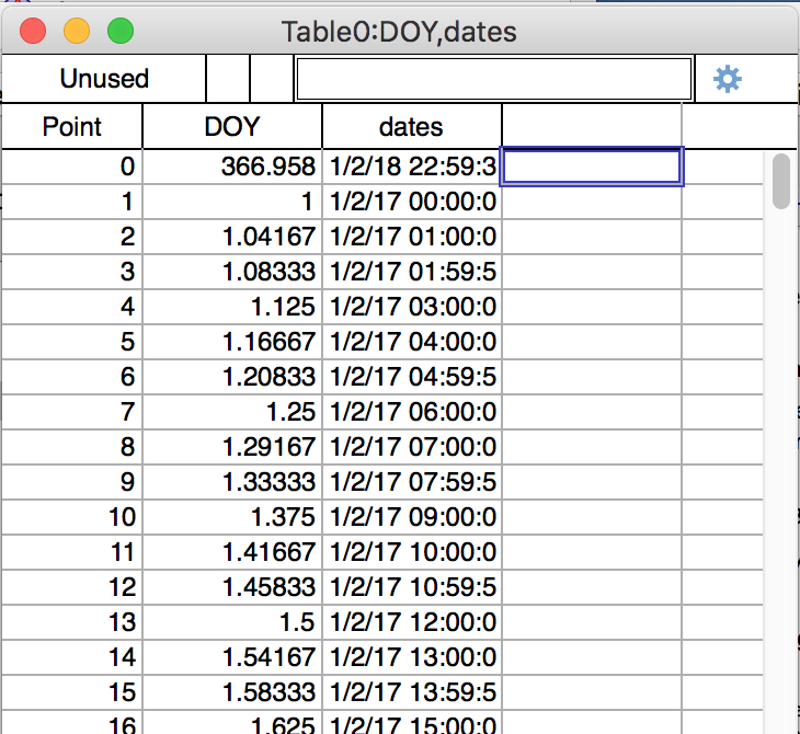

Those numbers are fractional days from the beginning of a year? You could use Date2Secs(2017, 1, 1)+86400*(fractional day). You say it starts with Jan 1, 2017, but the first number is clearly the end of a year. For instance:
make/D/N=(numpnts(DOY)) dates
•dates = Date2Secs(2017, 1, 1)+86400*DOY
The wave DOY was made by copying your text and pasting into an Igor table. In the attached picture of an Igor table, I set the format of the "dates" column by right-clicking and selecting Format->Date and Time.
