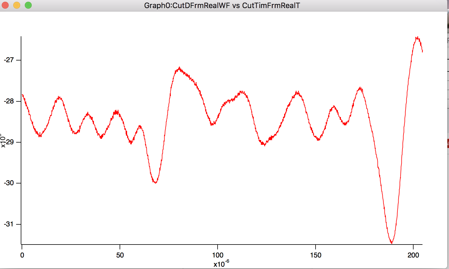

In the attached experiment, CutDFrmRealWF (y value), CutTimFrmRealT (x value) are examples of a single waveform and they are one cut from RealWaveForms and RealWavTime waves which contain hundreds of them. I want to do the fit for 2/3 highest peaks in the CutDFrmRealWF vs CutTimFrmRealT plot and iterate it for for all waveforms residing RealWaveForms and RealWavTime waves and extract the fit values.

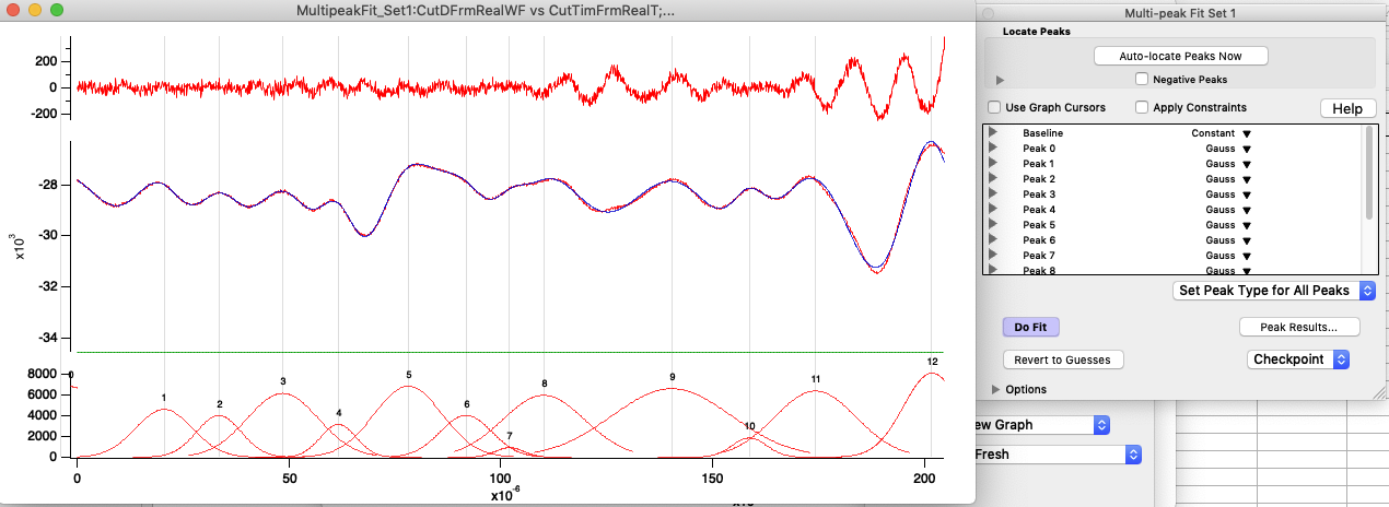

I wanted to make sure that the auto peak find algorithm (which I have adopted from the multi-peak fitting package and modified it to my use) works fine for all the waveforms residing in a wave. Unfortunately, it works fine for most of the waveforms but does not work for some waveforms (for example, for waveform 57 if you insert 56 in the prompt window) which screwed up the whole algorithm. I think it might be a bug that is responsible for it.

depending on where want to go with this, you might be better off writing your own peak finder instead of relying on the Autopeak Finder, which has to cover a much wider scope and thus cannot pinpoint your use case as well. It is not that difficult: Just look in the (smoothed) first and second derivative of your data for zero crossings and the maxima (minima). First, you data looks more like its a sum of sine waves than a spectrum with distinct peaks, so I do not know exactly what you are after. But examining your example I found that the Autopeak Finder might have difficulties estimating the right smoothing factor and noise level. This is a limitation from not being able to assume anything from your data and just running some statistics on it. Since you are knowledgeable about your data, you could do better as mentioned above. I just hard-coded some values for the noise (=0) and smoothing (=10) in your AutomaticallyFindPeaks() function like this:
AutoFindPeaksWorker(w, wx, pBegin, pEnd, maxPeaks, minPeakPercent, 0, 10)
I think this works more or less. At least it seems to find all structures I would consider to be a peak in your data. You can play around with this more and see what works best for you. Hope that helps.
