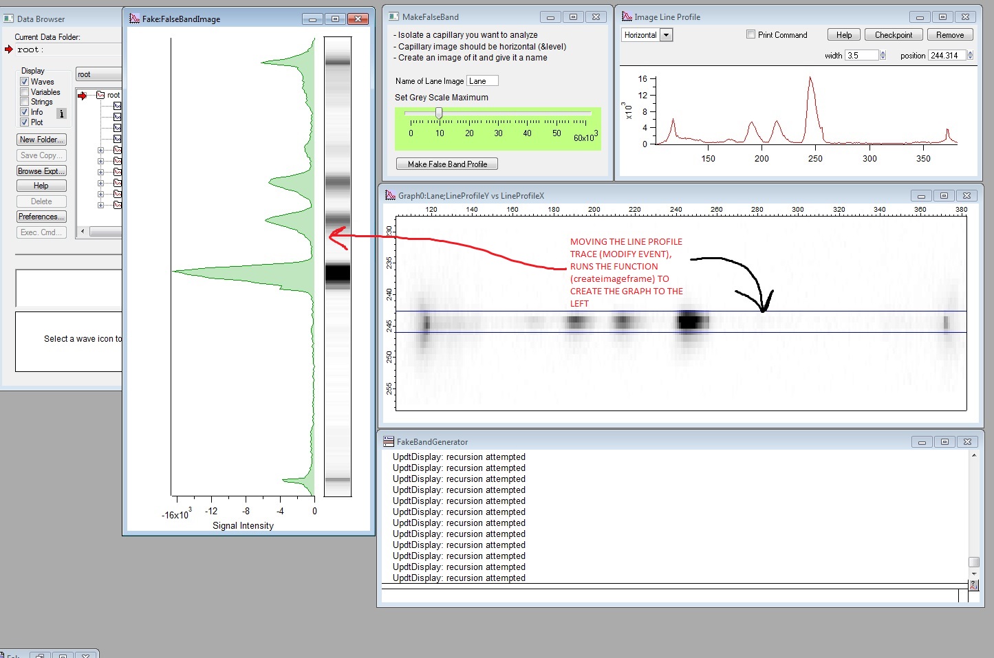

UpdtDisplay: recursion attempted printed in Command Window
I've use a hook function which calls a function after a graph has been modified. Each time the graph is modified(I'm moving a trace), four instances of "UpdtDisplay: rescursion attempted" is printed in the command line. What is causing the print at the command line and can I get it to stop?

Hi John,
Thanks for the reply. I tried your code and still have problem. I'm attaching a screen shot of what I'm doing, as well as the additional code (createimageframe).

OK- I'm not exactly certain why that triggers the Recursion Attempted message, but killing and creating graphs inside a graph Modified event may not be the best thing to do. You can get around it using Execute/P to put off running the function until all the excitement is done. Instead of this:
			SVar TW=root:LaneName
			wave w=$TW
			createimageframe(w)
do this:
			Execute/P "createimageframe("+TW+")"
You'll find that this litters your history with calls to createimageframe. But you'll see what it's doing that way. To get rid of the litter, add /Q after /P.
But really, you don't want to do it this way. Destroying and re-making the graph is time-consuming, and as you see, fraught with difficulties. I would note the documentation for DoWindow/R, where it says:
"However, /R does nothing if a macro or function is running." I think all you want is the action of /K, so that's really not an issue, but still...
I would use the GraphNow() function to create the Fake graph, then in updateFakeBand() just modify the waves being displayed in Fake.
OK- I just ran Igor under a debugger so I could figure out why your code triggers that message. It should have been obvious (to me)... The Modified event comes during a display update, when Igor notices that your graph has been modified. But your Display command also triggers a display update, when Igor is already in the middle of a display update. And that's why Execute/P fixes it: it puts off the destruction and creation of a graph until after the window hook function is finished, which will be after the original display update is finished.
I still recommend doing the job differently!
