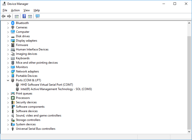

I'm using VDT2 to read in some data from various serial devices.  Recently I've noticed that when I add a serial device and it shows up with a new COM port number in VDT2 settings and device manager, it may not show up with VDTGetPortList2/SCAN.
I tried this using a COM Port emulator.  I made a virtual COM Port that shows up in device manager.  It also shows up in the dialog of VDT2 Settings.  However, it does not show up in the string created by VDTGetPortList2/SCAN

I used this program
https://freevirtualserialports.com/ and created a listening port
This is my very basic code
Function/S FindPorts()
	string allports
	//VDT2 resetports
	VDTGetPortList2
	allports = S_VDT
	return allports
Here are my command line executions:
Without new port and no /SCAN flag:
•print FindPorts()
  COM3;
With new port and no /SCAN flag and no port reset
•print FindPorts()
  COM3;
After port reset
•print FindPorts()
  COM3;COM7;
With new port and WITH /SCAN flag (again after port reset)
•print FindPorts()
  COM3;
com port list.png (28.85 KB)
