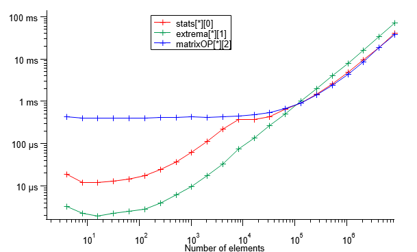

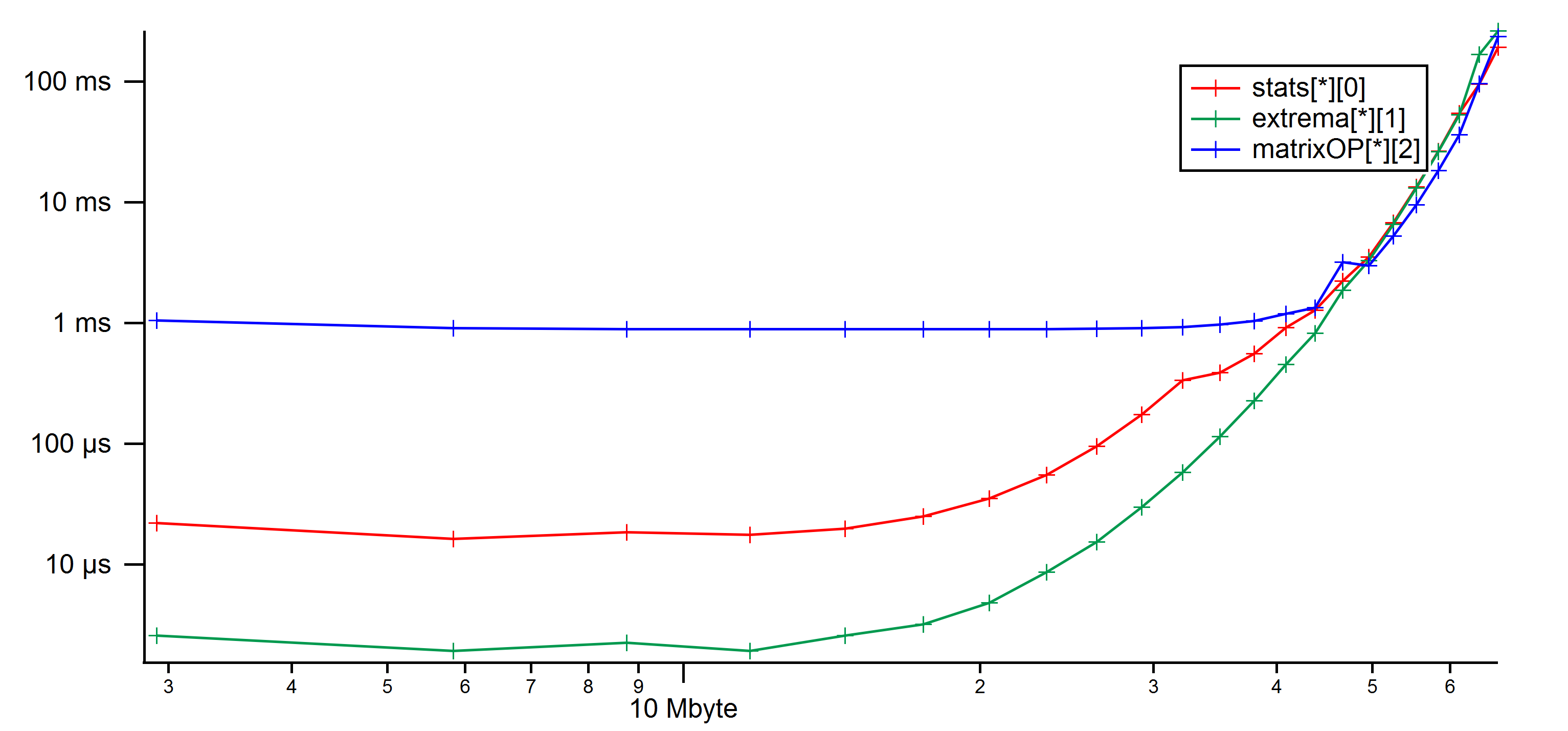

gives the attached graph.
So WaveMin/WaveMax is the fastest.
That's interesting. Your bottom axis label says, "Number of Elements" but the tick label says, "10 MByte". Which is it?
What sort of hardware and OS are you using for this test?
I just looked at our source code, and the underlying code actually gets the min and max together, then WaveMin and WaveMax return the one that is asked for. So I started implementing WaveMinMax for Igor 9 and immediately ran into a problem. How do I return the result? The result has two values... I suppose we could return a complex number, but that's an ugly hack.
I've adapted the code and graph. The x units are bytes.
I'm on Windows 7 with an i7-3930K@3.2GHz and 64GB RAM.

Also, the documentation for WaveMin says "For a floating-point wave, WaveMin runs about three times faster than getting the same information using WaveStats. For an integer wave, WaveMin runs about ten times faster than WaveStats. The advantage may not hold for short waves.". A similar statement is present for WaveMax. I'm not sure when that was written, but it's not completely accurate at least for large waves. I believe that's because WaveStats is automatically multithreaded and for large waves that improves its performance substantially. WaveMin and WaveMax are not automatically multithreaded.

Running the above gives Graph9.png.

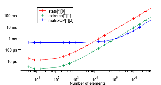

The strange shape of the red line is due to the fact that WaveStats is automatically multithreaded. If I first execute
MultiThreadingControl setMode=0
and the I rerun the test, I get results in Graph10.png.
