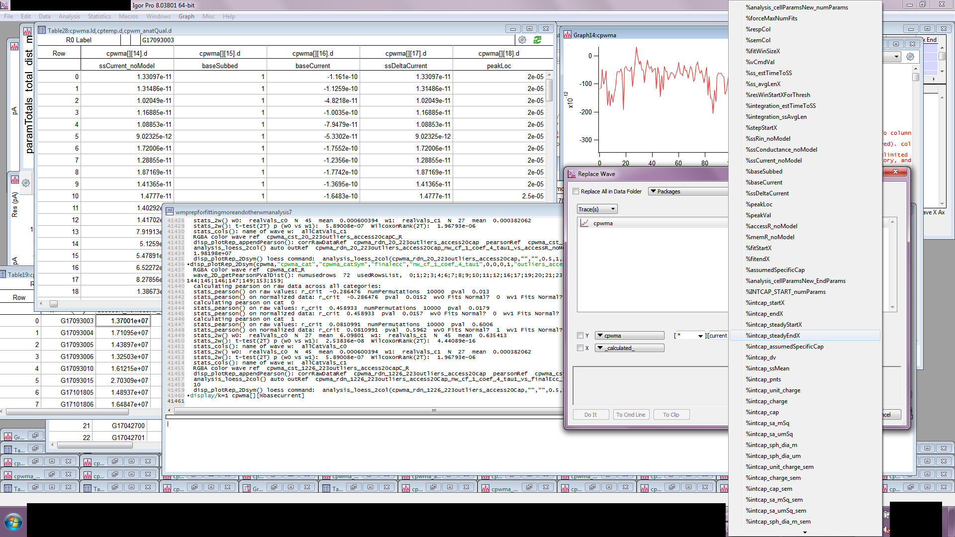

1. In GUI drop down menus where an index can be specified by its subrange, allow keyboard entry so that scrolling is not the only way to find the label of interest. Right now, I often would have to scroll through hundreds of labels to find the right one -- see the attached example, where scrolling and searching could take many minutes. Instead, I can pick a dummy one and then change to the correct label on the command line, but that is inconvenient.
